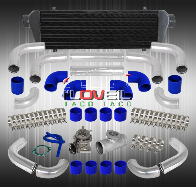

I know plastic piping is not ideal absorbing engine heat and such, and intercooler is small... would I be better off getting universal eBay kit with 2.25 or 2.5 inch piping such as this:
People either do that or buy mandrel bent piping instead, which usually costs more.
One of those kits should be able to get you done up good and I guess an intercooler is an intercooler so I wouldn't worry about quality of it, just do the routing right.

don't use the MSP stock stuff. Seriously, I'm telling you from experience, the plastic pipes are prone to cracking. MUCH better off getting the ebay kit, which is what a lot of MSP guys do anyway. I have a Spearco FMIC with a Greddy Type-S BOV and custom pipes on mine.
Has anyone used the eBay kits on their MX-3 and have pictures? Seems like a lot of the worklogs I am seeing have custom piping with welding, something I will not have much access to. I wonder if the kit itself will have sufficient piping to complete the setup without much difficulty. These eBay kits above are 2.5" piping, would I be better off using 2.25" piping?
So yeah, this is an Ebay kit. minus the IC which is a CS intercooler. I used one kit with silicone couplers and T bolt style clamps. Took very little time to mount it in place. Before this I had a Probe IC (same as the 323) and ran it mounted at the base of the engine bay for a sleek stealthy look. Had that on there for about 2 years. I would use 2.5" piping.
Awesome, thanks for the pictures Josh that helps a ton, will most likely get this ebay 2.5 kit with the intercooler. Will keep you on PM speed dial during my build
For anyone interested or in the market there is a very sweet deal on black FMIC + 12pc 2.5" piping + BOV with silicone couplers I got for <$100!!! heres the link... http://www.ebay.com/itm/230969403484?it ... 60&vxp=mtr
Most other kits (comparable.. including BOV) I was looking at on eBay were at least $150 and that was the cheapest price I found until this one!
