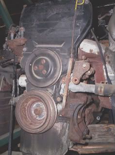

Heres another engine supposedly 53k miles from EGT looks pretty rusted wants $300 + $260 freight shipping
Re: BP shopping
It'd be a good price without the shipping... I'd call him on the 56k miles. I'd double that.

Here are the choices, found all on car-part.com which has been my main resource. By no means and I limited to just these but these are ones I have looked into.
-91 EGT pictured above supposedly 53k for $300/260 freight shipped
