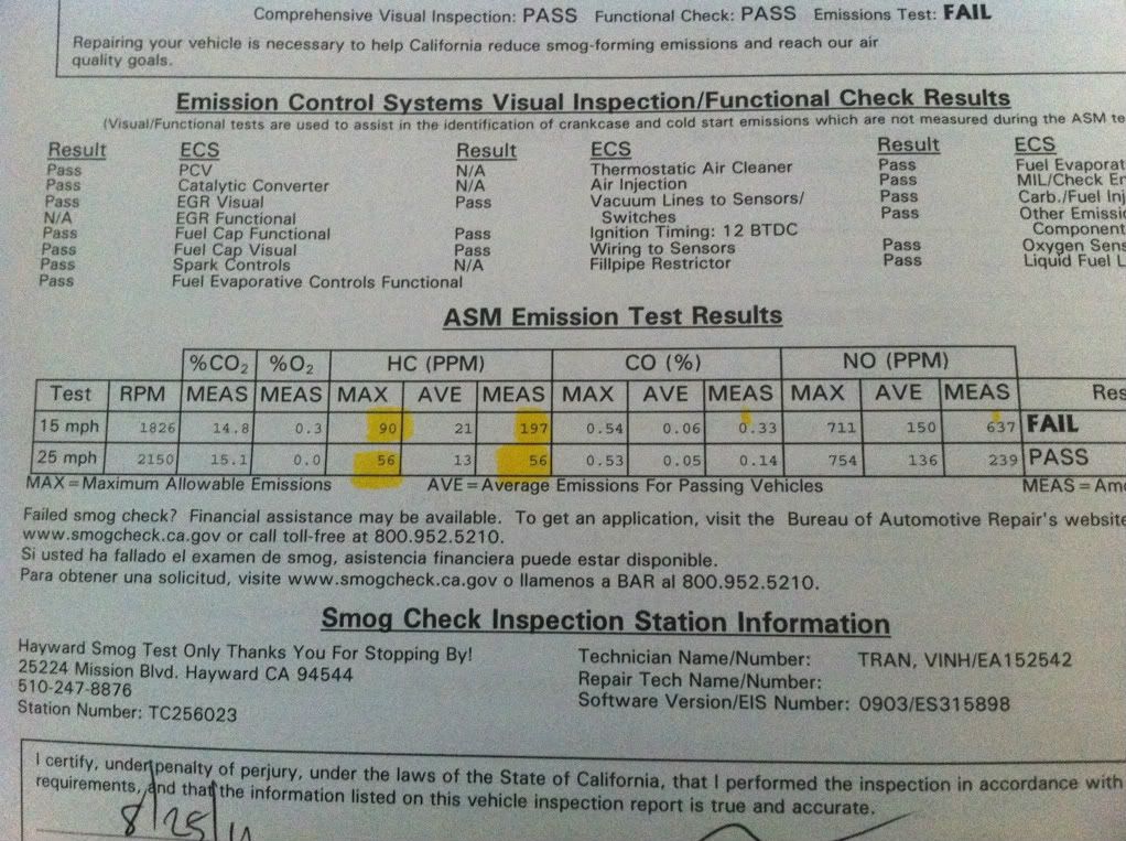

What do you guys think about this? The car has not been run for more than a year and I did the first test just to see where i am at and this is the result:
http://i1101.photobucket.com/albums/g42 ... 07cb7f.jpg

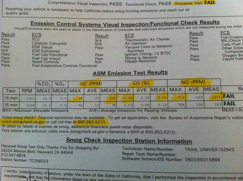

Used up the gas and put in new one and also used seafoam and now here is the result:
http://i1101.photobucket.com/albums/g42 ... ecfce3.jpg

You need to run an entire tank of fuel through before going for an E test once a car has sat like yours. Do all the usual tune up checks and then before going to get checked again buy gas with methanol/ethanol blend and add 5+oz of acetone to the fuel.
There's lots of pros and cons about acetone use, Google and decide for yourself. It reduced my emissions that's all I know.

Thanks Dan. The problem I have is that I can only get a one day pass. And each time I have to go to DMV to get that pass.
Is the Ignition Timing (12 BTDC) right? I checked the manual and it says 10BDTC (+- 1)

Re: Smog fail - High HC
I I tried pulling the PVC out and my HC lowered. Additionally, there's a rpm range, Ours is 2250-2700. I found if we kept the rpm near 2300 my HC was less.
