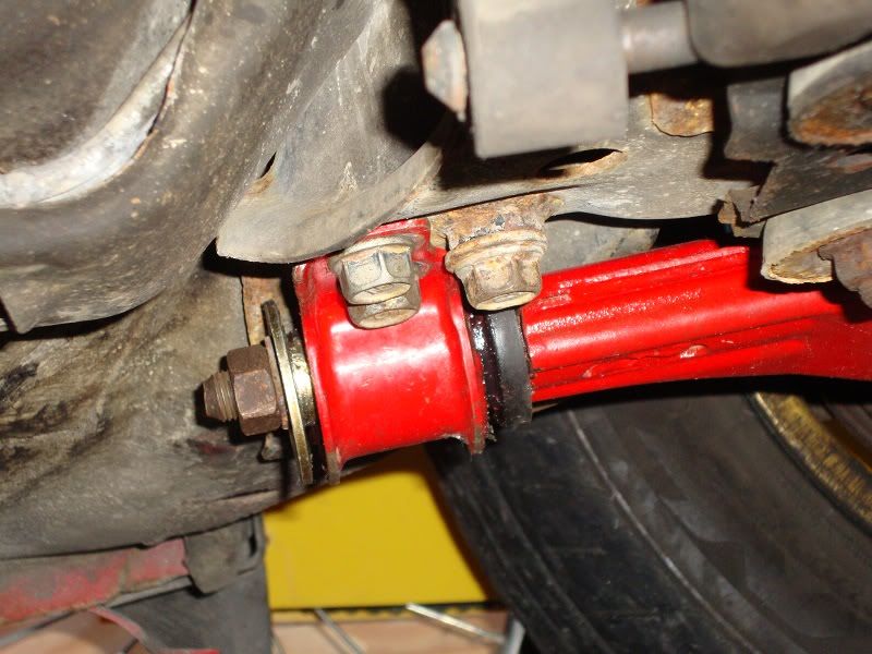

are you sure thats right? i installed mine like you said and i also had problems with the bushing pulling out 1/4".IMACHU2 wrote:
Ya It was kinda confusing. Four busings and two washers in a box. They did not even wish you luck, never mind instructions. I have 4 BG's to look at so I was lucky. I kept the suspension from my $200 323 to roll the shell of my car around. I looked at it ten times LOL. (5 times for the front and 5 times for the rear).
im thinking the bushing should be installed with the fat part towards the rear of the car. it would make more sense for the big washer to be sandwiching the fat end against the #13 bracket no? or is the bushing supposd to seat itself against the control arm like it has in my pic? at least for the back one anyways. havnt noticed any problems with the front one yet.
Re: Energy Suspension MX-3 Front Control Arm Bushing How-To
I definitely think the shoulder of the bushing should be to the rear with the washer securing it to the bracket.
- Posts: 1751
- Location: Vancouver, BC
only the one side has pushed out and the other is stuck in the bracket so ill fix the one side and keep an eye on the other and fit it if/when it pulls out. i dont think its that dangerous as it doesnt look like its going anywhere.
It won't go anywhere but the shoulder of the bushing is supposed to keep it from riding up onto the LCA which will gouge out the ID of the bushing.
I would definitely , definitely turn that around asap. The control arm moves alot and that bushing is going to get killed in a hurry.
i would but my only problem is i have no way of getting it out without ruining the bushing. i used a vice to get the 1st one out. the 2nd one broke the steel plate on my vice in 2 places and i had to resort to setting it on fire with a torch to get it out. with a little patients and occasional inspection i should be able to grab it when it starts to come out before it has a chance to do any harm. i broke 2 screw drivers hammering with a 5lb hammer and it still didnt budge.
