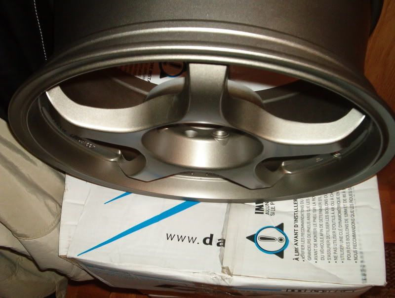

i bought a set of mags, like this model
http://www.driftnamiperformance.com/Mon ... 4100bz.htm" onclick="window.open(this.href);return false;
but in 16''x7'' 35 offset
now i'm looking for tires for this summer and i want to go as large as possible,
i know 225 can fit on 17'',but on 16?
i'm looking for comething like 225/50R16, do you think it'll fit my car if i'm currently running kyb gr2/technic spring(1.6''drop, 4 years old, so somewhat lower)
i need your advices!
will it fit?
will it fit?
