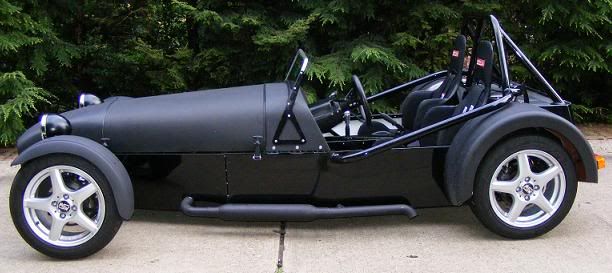

The car is a hand built Lotus 7 replica. It has 1987 Toyota truck spindles and brakes, rear axle. It has custom 4 link rear suspension, and very trick cantilever front suspension. Yes those are air bag, the rear is bagged too. I am also skeptical, but I am going to try them out, if it sux I can always convert it to coilovers.
With some work, it should look something like this:
