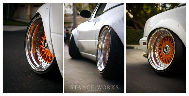

So I am still learning as I go about cars. I have been searching for awhile but there is not really a beginners section for this category. At the moment I don't know a hole lot about this category. What I'm asking is what all would I need to achieve this look on a mx3? Also if someone could point out some valid pros/cons/risk.

Coilovers for a start.
Rolled arches, as in the inner lip rolled up out the way.
16/17 x 8/9J lower offset alloys.
stretched tyres
camber bolts
Pros> it looks awesome imo, less tyre sidewall flex with the stretched tyres.
Cons > its expensive!

8J is how wide the wheels are as in 8 inches wide. Lower offset as in ET which will move the wheel centre out, and the stretched tyres
to get the tread back under the arches.

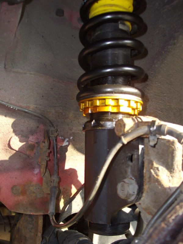

Coilovers suspension will replace your normal suspension strut tower with fully height/damping adjustment units.
I still have full travel and a smooth ride, although the bottom of the car grinds going up my driveway

coilovers dont use lowering springs as such, the shock body is threaded so by winding that up/down on the bottom mount you acheive the desired height.
