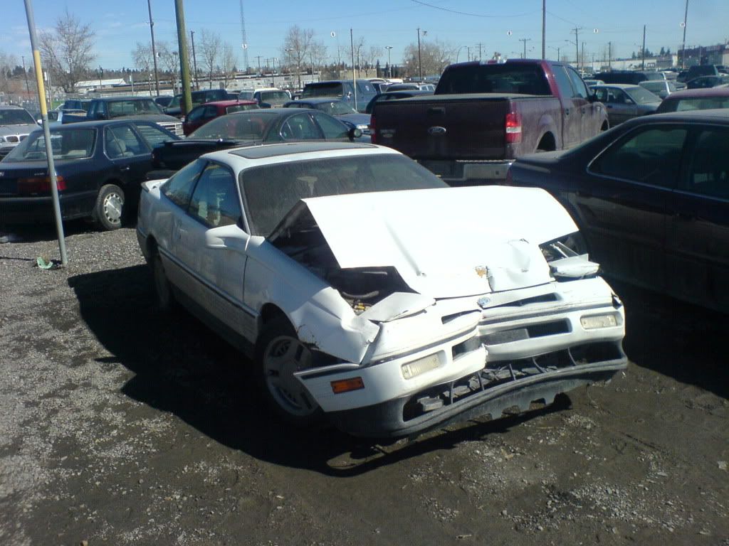

So I lost my last car do to the careless driving of another, 89 probe gt turbo, was a great car and fast off the line, not so great in the corners lol
before...
after...
:crying:
