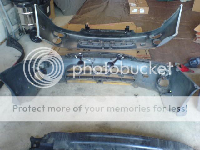

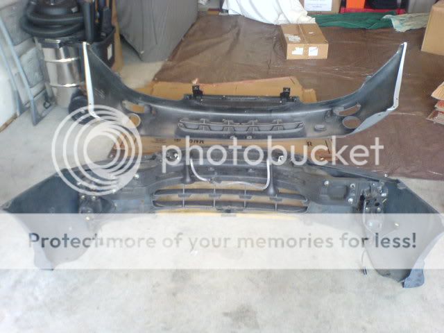

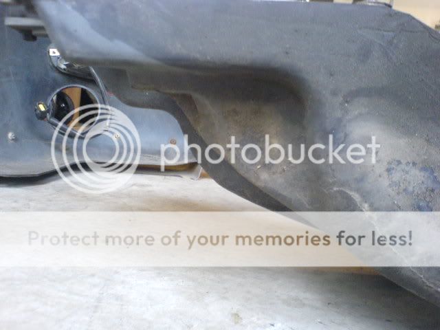

USDM bumper
EDM bumpers:

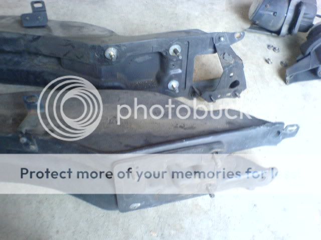

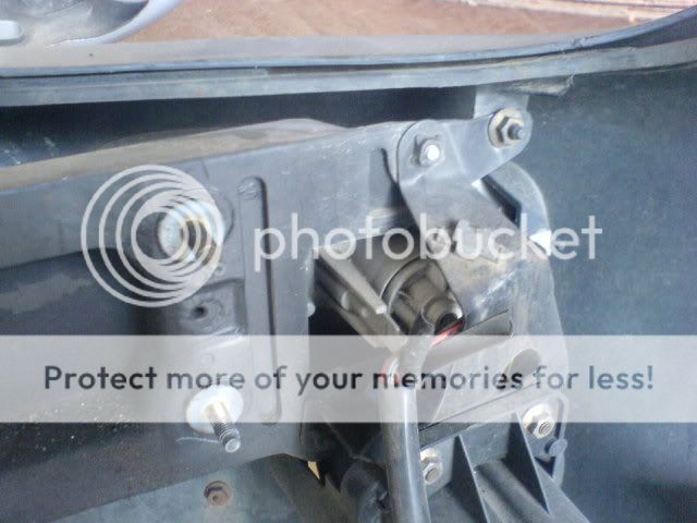

USDM support:

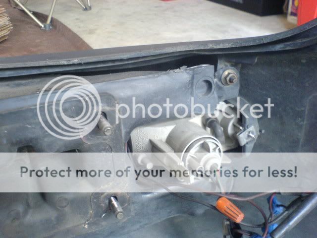

EDM support (with foglight bracket):

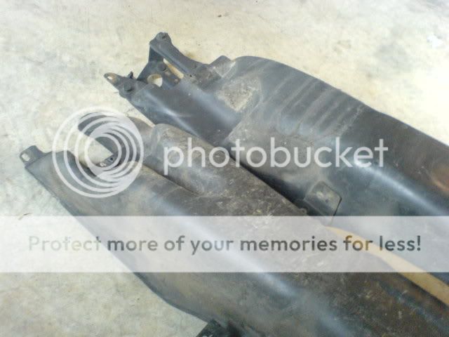

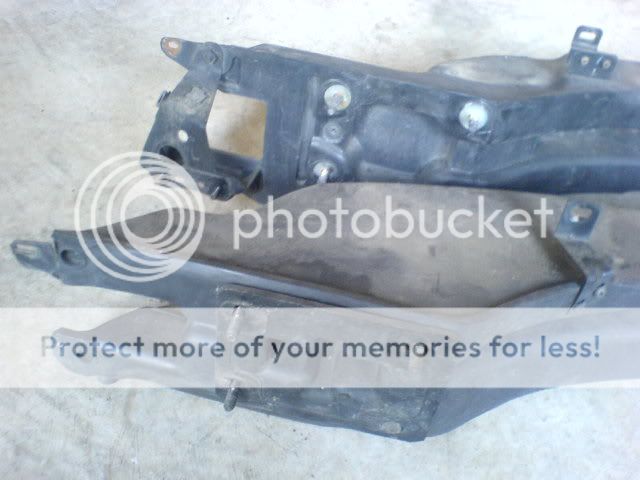

Comparision pics (USDM is thicker/bulkier):
This pic shows how far off the USDM support is off to accomodate the foglight bracket

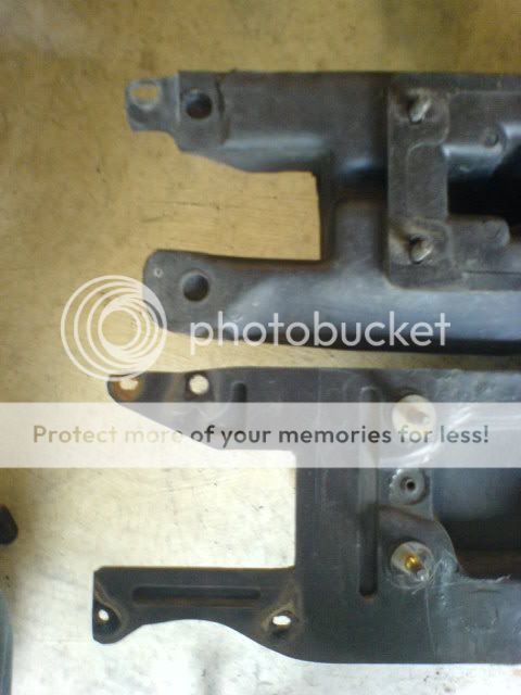

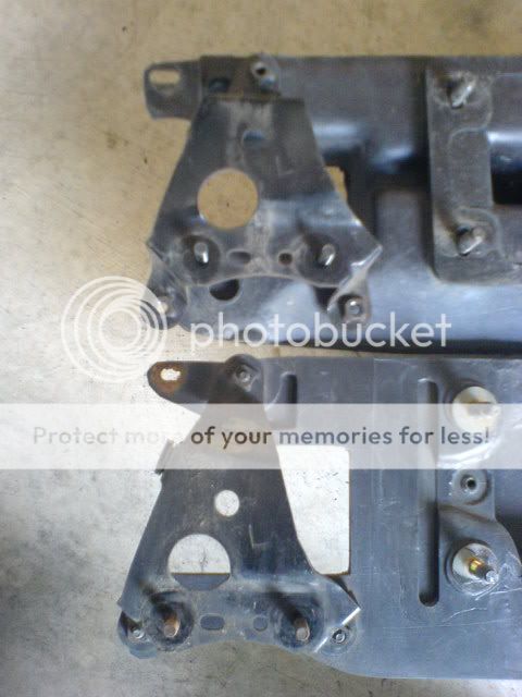

USDM top, EDM bottom
I was surprised just how much less bulkier and lighter (by a couple pounds) the EDM support is!
