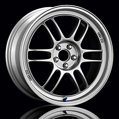

The Enkei RPF1's look almost identical to the Kosei ones but are more expensive

RPF1 = WIN
/end thread

I like the RPF1's look - same reason I like the Kosei's. Theyre closer in price then you'd think. I know Enkei makes good wheels.
What color would you choose? Silver?

The kosei's are also sick, but the styling is abit outdated. Silver is a good color if you are going 15 or 16..
Lol Noooo they don't and did you bothered reading the difference in weight lol They are no where NEAR alike :)

More info on Enkei RFP1 - showing their quality!
http://www.good-win-racing.com/Mazda-Pe ... -1049.html" onclick="window.open(this.href);return false;
A miata wheel should be light, and a Miata wheel should be strong...with a quality finish that lasts and lasts. These Miata wheels are a personal favorite for their combination of great quality, great finish, strength, lightness and price. Just 9.8 pounds for 15x7 size!!! Compare that to SSRs and VOLKS or any other choice with this quality and you will realize what a bargain these Enkei RP-F1 Miata wheels are. Although the Kosei K1-TS Miata wheels we have look similar in the pictures here don't be fooled, this Enkei RP-F1 Miata wheel has a much better finish quality, and has proven MUCH stronger. Rolling Rim technology means forged=like strength and grain alignment similar to forged wheels costing much more! The 41mm offset puts this right in the factory Miata wheel offset range. Note that Enkei does not make a center cap for this size but our KONIG HELIUM center caps will fit this Miata wheel if you must have center caps (remove rear spring from Helium cap, insert main disc from the cap, and spray paint the small quarter-size "Konig" label before installing). Takes a standard 73/54 hubcentric ring sold elsewhere on this website. We strongly recommend you do NOT use your factory lugs, a narrow lug will fit better and not scratch your new wheels! All our lugs are extended length for more contact with the studs and narrow to avoid scratching (see our McGard Spline Drive Lugs in particular). Does NOT fit with the factory Mazda Miata big brakes (optional in 2001-2002, standard in 2003-2005). Also does NOT fit with aftermarket Miata big brake kits. These have proven much stronger than the forged SSR wheels and yet these cost less. This is the strongest AND lightest 15 inch wheel we carry! Mazda trusts Enkei to make the factory Miata wheels, so you can trust in Enkei for the highest quality at the best price. Also fits many other 4x100 lug pattern cars including many Hondas and Toyotas, Scions, etc.
Part Number: 21-1049
Price: $179.00
My only question now is the 41mm offset - I know this is very close to stock and running 205-55/R15 Tires SHOULDN'T rub, but I plan to drive aggressively w/ my car somewhat lowered on GC's and ZX2's. (Not slammed). I was looking more for a +38 wheel because I KNOW I will not have clearance issues. Thoughts? I COULD bump up to a 16x7 wheel for not too much more money, but they are +35.
