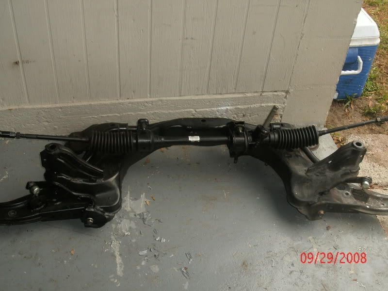

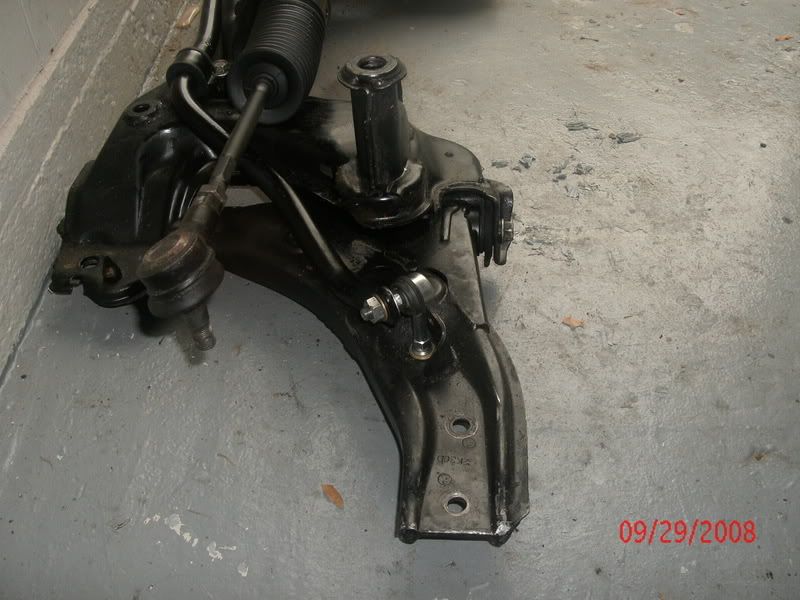

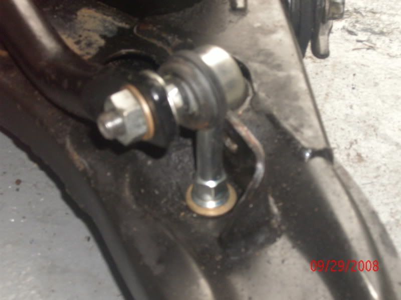

So my front sway bar droplinks were garbage from years of abuse and needed to be replaced but the problem was the only place to get them was the dealer for 63.00 each! So then I said theres got to be another way and found out the 89-98 240sx links bolt right up I have to say are alot stiffer then the crapy stock droplink design and best part is there only $20.00 each.
My new manual steering rack :love:
I used stainless and Grade8 bolts and washers for extra protection

Where did you get them?

Do you have a pic of them on their own?

Huh, are they the correct lenght, though? If so, that's not a bad deal.
Also, rockauto.com has front links for our cars for $23 each. Rear ones are BECK/ARNLEY for $62 each.

That picture makes me want to drop my front subframe and clean it.

Whisper wrote:Huh, are they the correct lenght, though? If so, that's not a bad deal.
there really close to stock link height but i will get mesurments today to be sure. None the less allignment will fix any issues

whats the steering rack out of :D

nos92mx3 wrote:whats the steering rack out of :D
90 323 hatch BG

The rack :wink:
