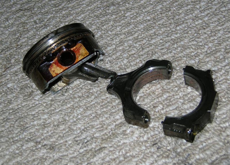

Until you can afford to get rods don't waste your money on the other parts. The puzzle is not complete without rods. Those are a key part of a motor built for boost. Just throw in a DE or ZE and boost it. Both can handle your goal of 300whp pretty reliably with a good tune. Spend the money you saved by putting in a stock DE to buy a megasquirt and run standalone. The key to boosting this motors is a good tune. Otherwise they'll go boom no matter what you have in them.
I ran 300whp on my ze reliably and can name three other DE/ZEs boosted on stock internals running a reliable 300whp. (Roughly 10psi on a ze and 12psi on a DE) 300whp us about peak for the millenia 280 injectors, but they can do it.
For reference this what a stock rod does under higher boost levels.
This is what the rods in my built motor look like compared to stock.
