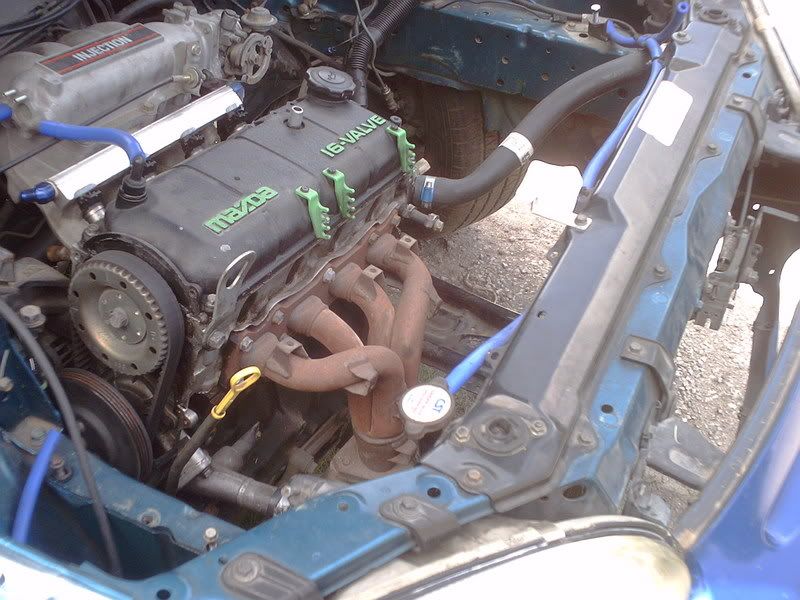

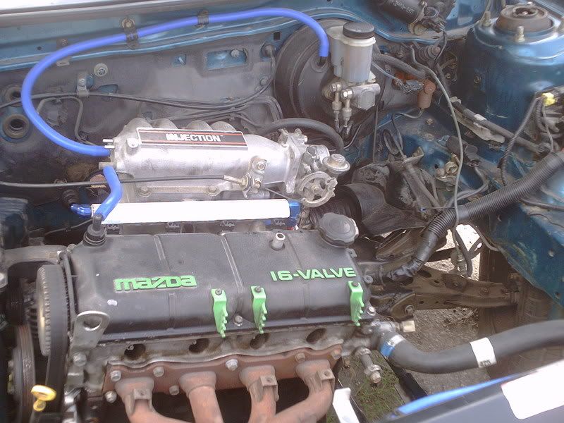

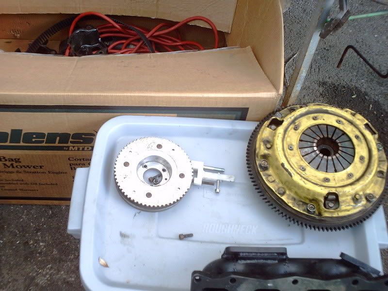

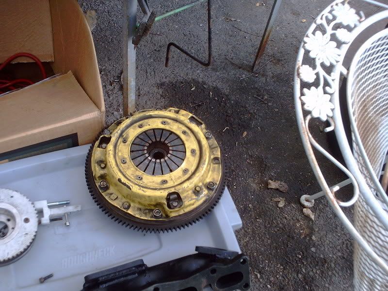

any ?'s just ask and i'll reply back. thiers a start.
RM log style turbo manifold
GT32 turbo
TEC II standalone,
RC 550cc injecters,
UPgraded fuel rail already in place
26 3/4" L x 6 1/4" H x 3 1/2" D FMIC
2in intercooler piping
tial wastegate/BOV
F-series trans with a miata 1.6 flywheel act XTREME pressure plate mx-3 disc
MSD 8.5 wires
NGK V-Power plugs R5671A-8

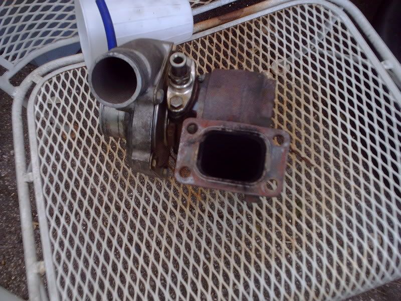

LIME YOU ARE THE EFFING MAN!!!! so where did you get your turbo manifold? and what is the gt32 turbo out of, what is it expected to push for hp? when is this getting done, i cant wait to see it, your my idol lol.

Rm (racing mazda) member i work there part-time. thats where the manifold was from. discountied item i have the last one made. LOL

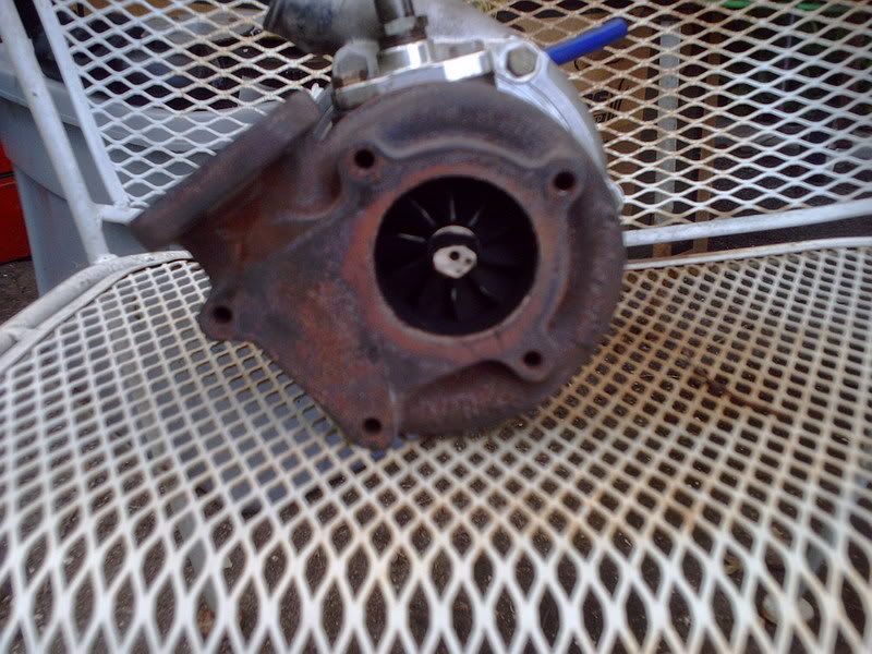

Turbo is a GT series turbo, sorry man u won't find it off another car. aftermarket turbo. that same size turbo made 334whp @ 25psi on a1.6 dohc miata. it can make some power.

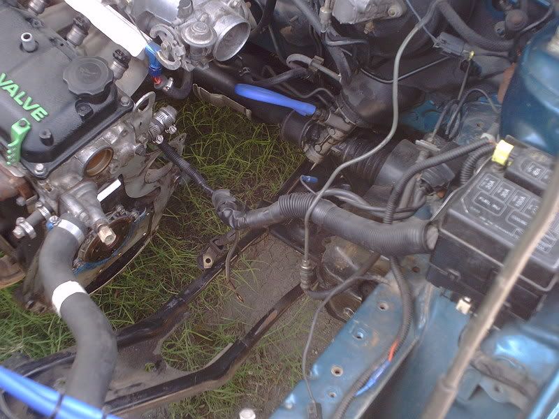

not good to let the engine hang by one engine mount. Good way to tear it. That one is not very strong anyway.
Good luck with the project. It will be fun till it blows up!

hes got it jacked up underneath.

atlantamx3 wrote:not good to let the engine hang by one engine mount. Good way to tear it. That one is not very strong anyway.
thats a solid motor mount made by josh hell yeah it will
