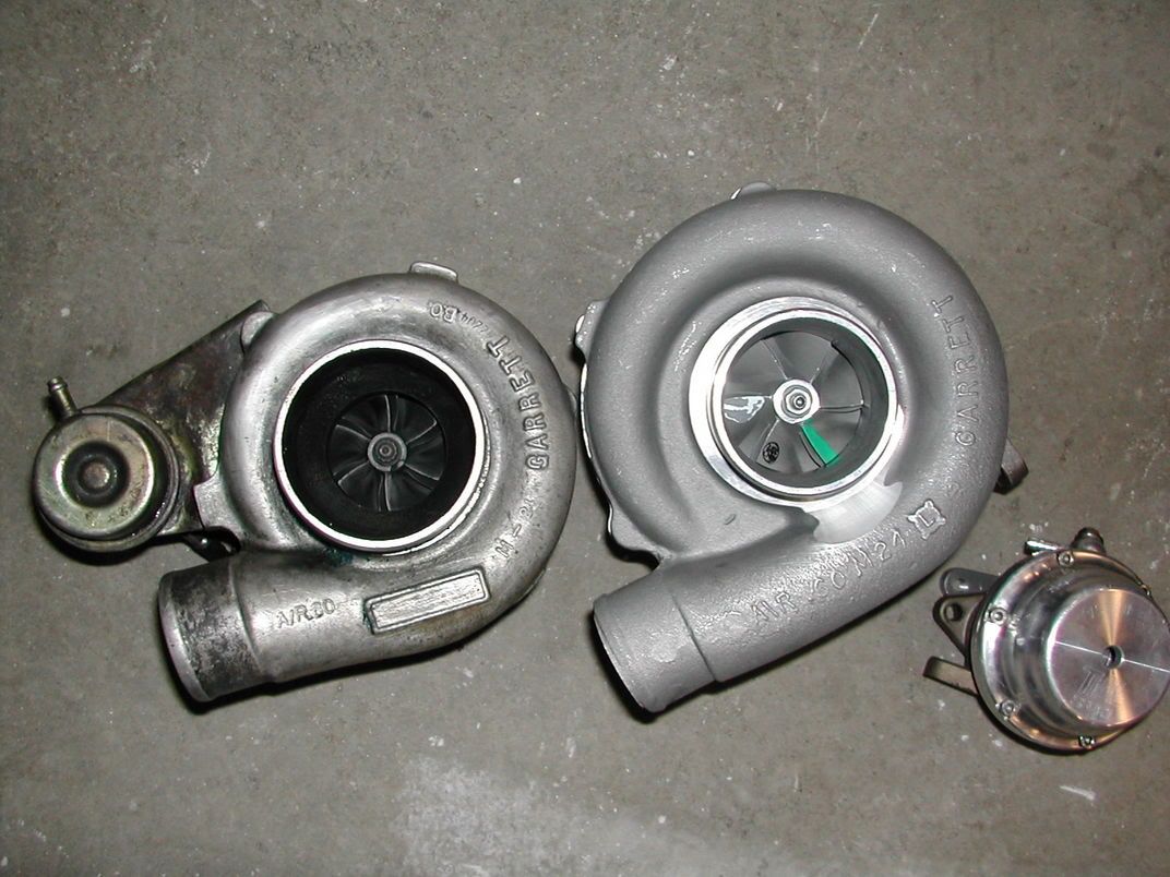

id like to ask if you have you ever had the two turbos mentioned in the link you posted in hand?
the gt28rs on the left and a t3/t4 57 trim. closest picture i could find..
just so everyone that doesnt already know a gt28rs is much smaller than the t3/t4 listed in the link you posted above. the t3/t4 with the .63 a/r turbine housing is larger and capable of more power than the disco potatoe. due to the difference in size and capability, it does spool slower. btw, the gt28rs will be pushing its extreme limits to make just under 300whp where as the t3/t4 will do 400+ 500+.
the link does not state that obviously the same psi was used. the gt28rs dyno was probably nearly twice the boost level that the t3/t4. i wouldnt be surprised to find that the gt28rs is probably running near 18+ psi and the t3/t4 is probably running 10-12psi. it also does not say if timing and fuel were adjusted. its easy to leave out certain details.
im not bagging on the gt turbo's, they are well made and SOME of them are very good. doesnt mean they are all good. garrett got lucky with a few and threw the r or rs badge on them. more power to them for finding a few well matched turbos.

It is listed that the Disco Potato made 316/266 with 10psi and More Fuel. But what I don't get is why they had to do that. I wonder what PSI they were running on the t3/t4 to only have like 223/193....Steeb wrote:id like to ask if you have you ever had the two turbos mentioned in the link you posted in hand?

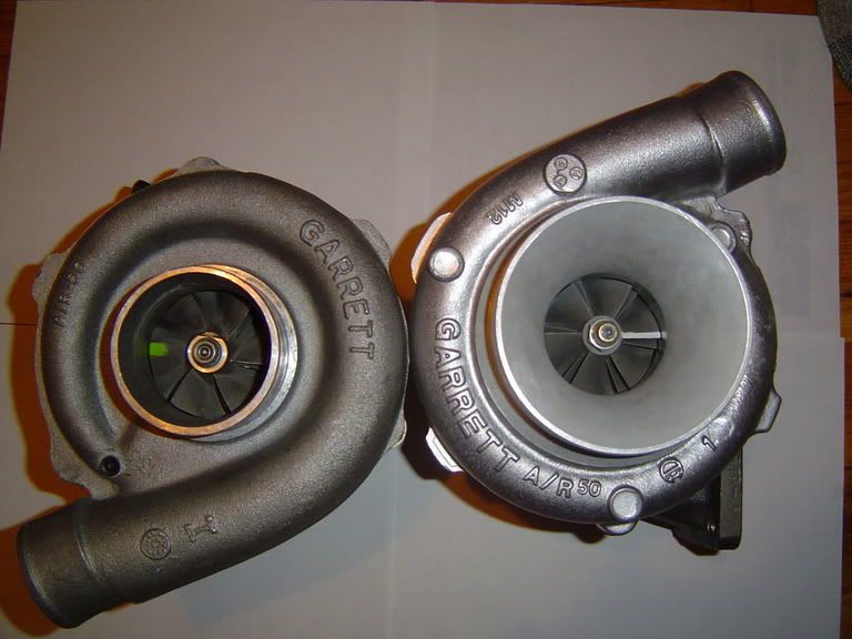

i hardly believe the gt28rs made that much power with 10psi. it would need more than 10psi with the gt30 to make that much power at the crank.
just go to your favorite search engine and type in the two words "gt28rs dyno" then click on search and images. you will find several dynos that are toping out at 300whp at over 18psi depending on which engine it is installed on.
like i said before 300whp is pushing the gt28rs to its extreme limits. to make that much power your engine better be built to handle over 18psi and probably race fuel or extremely careful tuning with gigantic injectors on pump gas.
t3/t4 depending on trim can make easy 400whp depending on trim.
