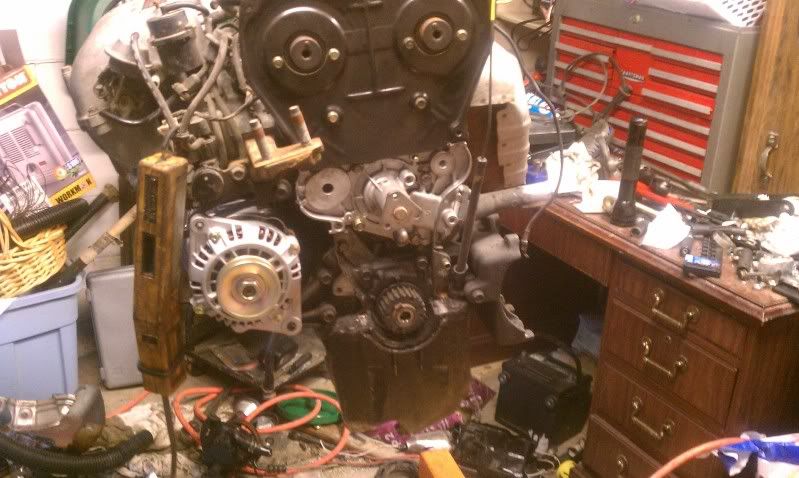

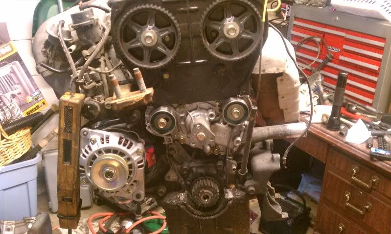

Got the alternator today. Looks just fine on the motor.
Also got the cam gears back on with the water pump, and the tensioners for the timing belt are in place. Going to hook the timing belt up shortly and then put the covers back in place.

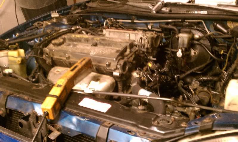

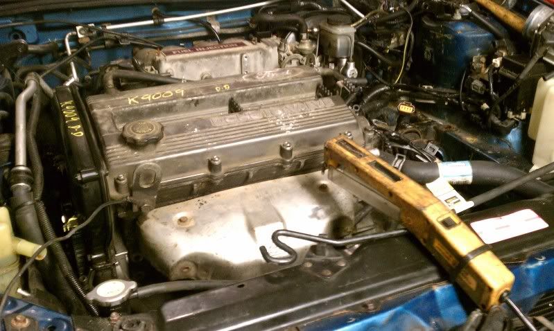

Update: Motor is in as of Wednesday. Would have been done today but waiting for a throttle body gasket (the motor had an ATX throttle body and so I couldn't use it) and 2 exhaust gaskets.

Looking good. (I mean, with the exception of that 4 letter word on your valve cover...)
So when are you expecting to have it running?

today hopefully. I have most of the wiring done with the exception of the throttle body and some wiring on the backside (oil pressure sensor, alternator, and still need to hook up the starter).
I also have to mount the power steering and a/c. Then I can mount the battery tray, battery, and intake.
I'm going to run it and flush the coolant system out first. I cleaned the coolant reservoir out so it looks nice and clean.

update:
advance ordered my throttle body gasket and it arrived. They forgot (and I forgot to check my receipt) to order the exhaust gasket. D'oh!!!
Anyways I decided to take today easy for that reason. So I got the following done:
-A/C and P/S are installed with belt tensioned.
-Rad hoses are on, as well as oil cooler to heater hose on.
-Alternator is wired up, and Starter is installed/wired up.
- my aftermarket oil pressure sending unit (for my gauge) is installed and now wired up. So now I can know what my oil pressure is haha. Oil filter is also installed.
- Driver's side wheel well is all bolted back up.
To do:
Passenger side wheel well
the other heater hose (I might replace it but want to see if advance has one in stock.. if not then I won't worry about it)
distributor
battery tray/battery
clamps for both heater hoses (need new ones)
intake
exhaust downpipe
after that I just need to fire her up and flush the coolant system. Adjust the distrubotr timing, make sure all belts are tightened properly, and then drive off!!!

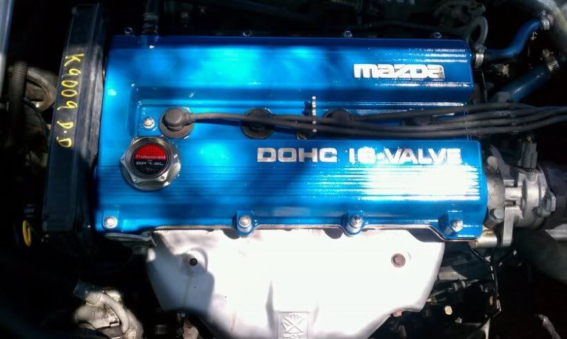

It's been a while since I've updated, but not much really to report. The new motor runs great, and everything is going good.
New goodies:
-1st gen Mazda VC painted blue
-painted the heat shield silver
-Chrome door latches
-eBay custom oil fill cap
