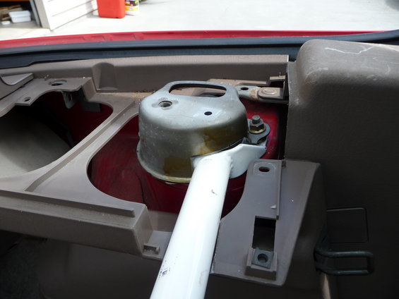

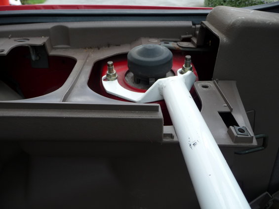

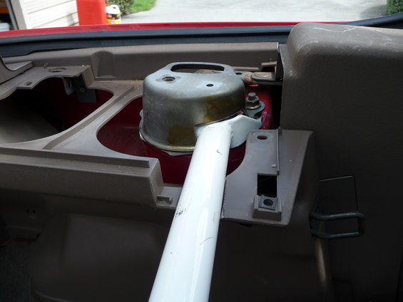

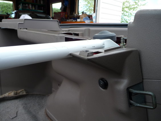

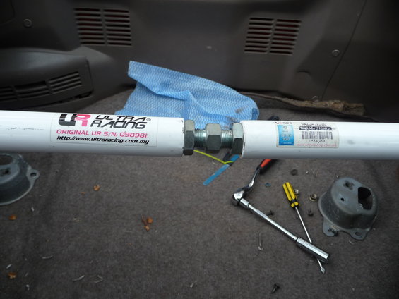

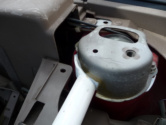

projectB10 wrote:Started to make a few changes to plain Jane...with a rear strut bar in prospect....struggling to find the time to play with this one.
Done. Little bit of work on a quiet Sunday afternoon...

Is that an UR strutbar for a 323 ? I've not seen it on a mx3 before.

WhiteFinish wrote:Is that an UR strutbar for a 323 ? I've not seen it on a mx3 before.
Yes its made for the BG chassis. Its similar to the UR-RE2-664 but has the central adjusting nut arrangement. The part #for the adjustable version is 664A The cross bar is round in section and like all the UR stuff the diameter is very "stout". The other bars I have used have been more oval shaped in cross section which in turn meant less cutting and modification to fit the bar shape into the interior plastics and the seat belt mounting.

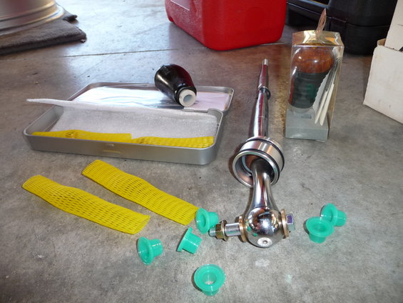

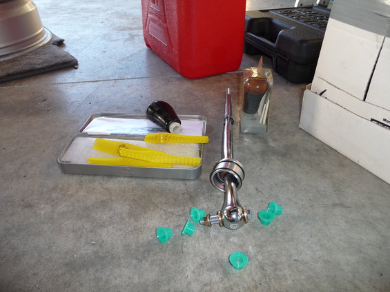

More parts preparation for the ATX to MTX transaxle swap. I have purchased the parts car and have an OEM VLSD and axles ex a Mazda Lantis so just need to find the time now. I intend to convert the linkage to a "shortshifter" arrangement. So many bits and pieces are required just to set that up the way I want it. I have used a combination of ebay shortshifter, Mazdaspeed knob, Corksport bronze bushing kit and Ford bushing kit with a 100mm GarageStar shift extender. I used this combination on the other car and its perfect for my needs.

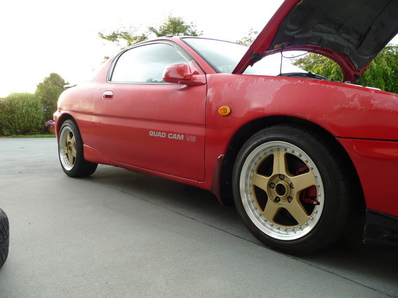

I am also going to convert the hubs (and brakes and spindles) from 4x100 to 5x114.3.
So Have gathered up some 2 full sets of JDM period 2 piece x 16" rims...Mazdaspeed LM's and "OLD" SSR Watanabe RS-8 in 8" width with +40 and +38 offset respectively for the two sets.
These cars are over 20 years old and I think that needs to be kept in mind when decking these things out in aftermarket parts.
I am going to refurbish the set of RS-8's with the face to be refinished in a gold colour. The RS-8's are significantly lighter than the LM's (not a very scientific assessment as the measure is by way of a set of WW bathroom scales!!!)
I am leaning towards the RS-8's but really do not like the current Black color finish...so will start to dismantle them so that I can get them off to the powdercoster.

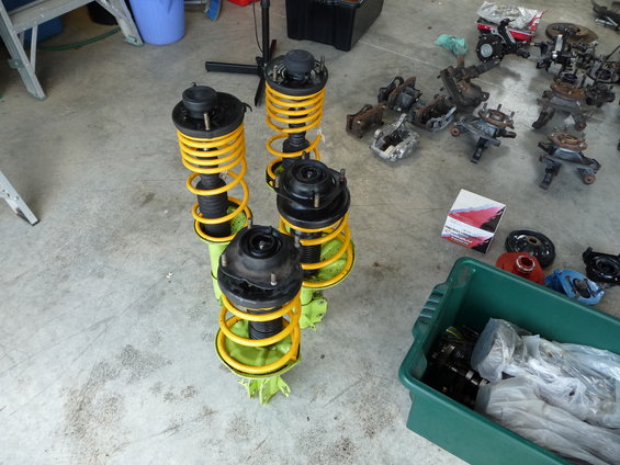

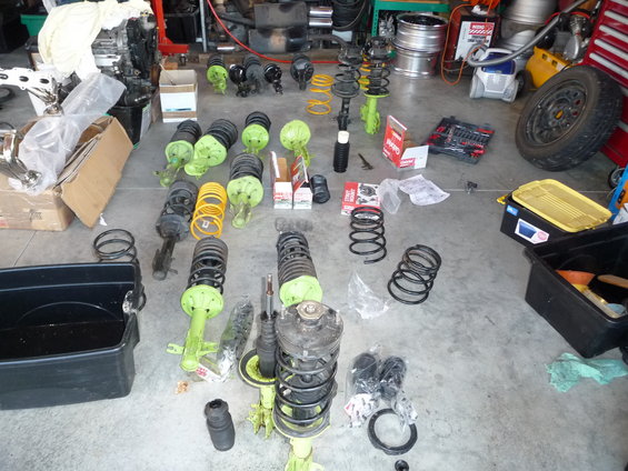

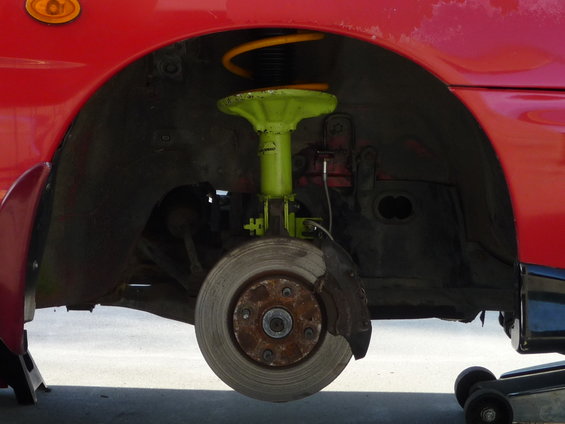

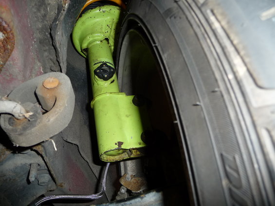

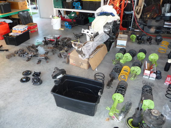

Finally found some time to make some progress;
Cleaned out some of the stockpiled new and second hand parts;
new steel braided brakes lines all round, 5 stud hub conversion, set of Mazdaspeed struts with King Springs, Mazda Lantis front spindles, calipers and rotors, Mazda Lantis rotors at rear, SuperPro double offset castor Poly bushes to rear bush (front control arms), Mazda Lantis rear suspension links with SuperPro Poly bushes front and rear and a set of Mazdaspeed MS01 LM in 16 x 8 with 40 offset. The tyres are 215mm section Dunlop Direzza. Only 3-4mm clearance "tyre too strut" at rear.

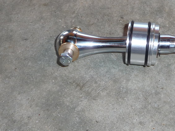

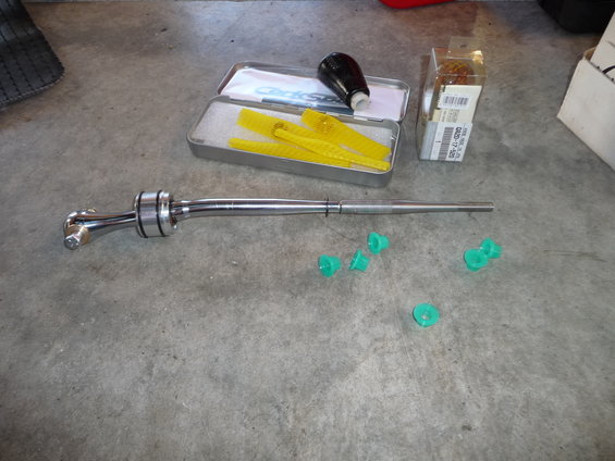

comparison of gearshift and stabiliser Mazda Lantis (top) and Eunos Presso
Presso...shows how Mazda fixed the drop through shifter problem
and the Mazda Lantis
Looks like I could have just used the Mazda Lantis gearshifter bits I had on hand rather than going to the trouble of hunting down a Presso to rob bits from for my ATX to MTX conversion.
Never mind...I need the Presso pedal set as the clutch pedal at least is different.

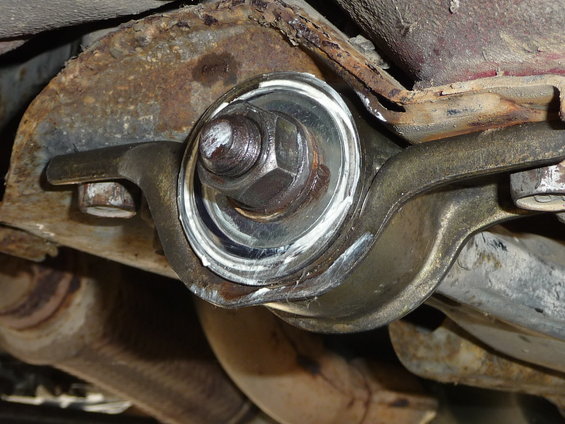

Gathered up another set of Mazda Lantis trailing links...I will SupePro them and fit then to The Passion Roase Mica car

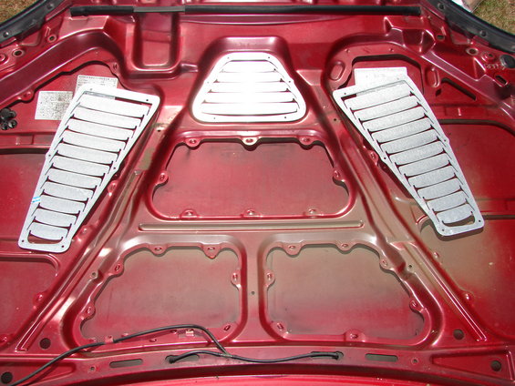

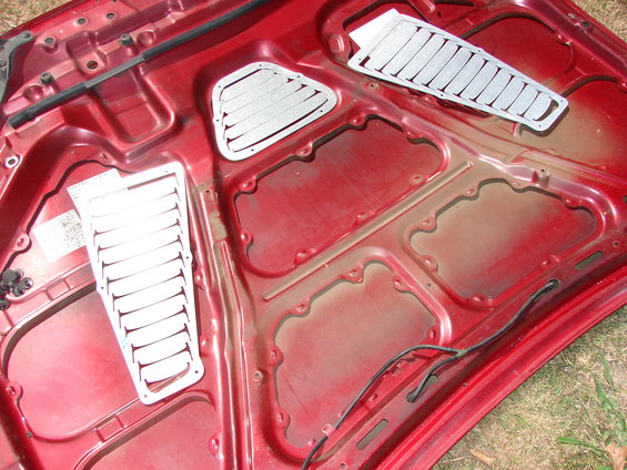

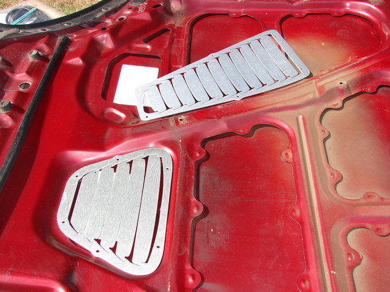

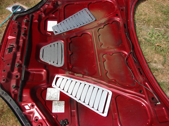

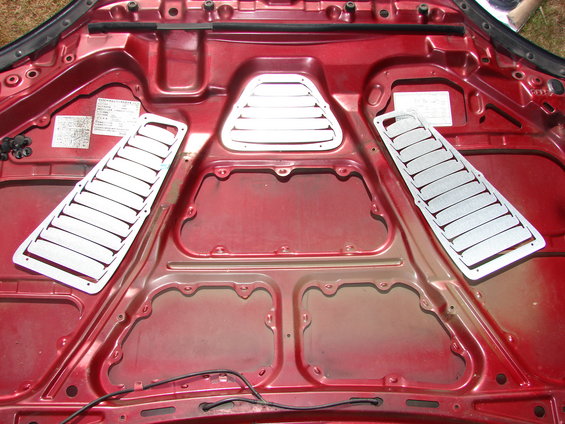

Just fooling around..
looking at the possible fitting options for a singular vent set for Miata) to a spare Presso hood.
Looking to use this set up on the Track Day car...

Did you use the lantis gear shifting assembly? That's pretty neat they fixed the dropping shifter issue like that
