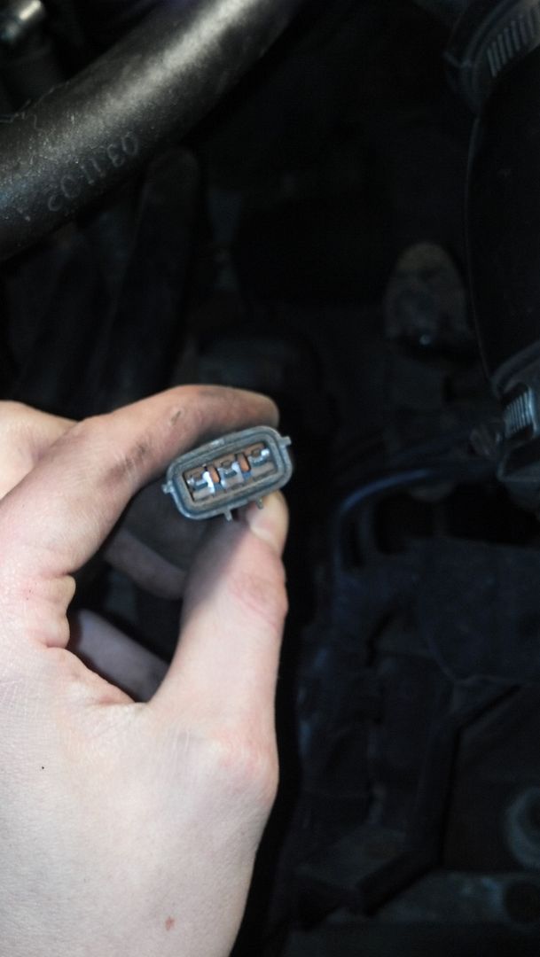

I found this connector that looks like it could be another end of the smaller connector from the distributor.
I have no idea where it does go but I think it may never have been connected. The distributor does spin but rather slowly.

That connector does look like it's one from distributor. Make sure all of your electrical connections are plugged in. Also since you've been cranking on it for so long your battery might be low, maybe put it on charger for a few hours.
Re: klze wont start
That connector is not distributor. It looks like VSS or EGR.
