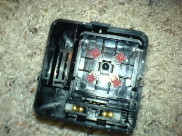

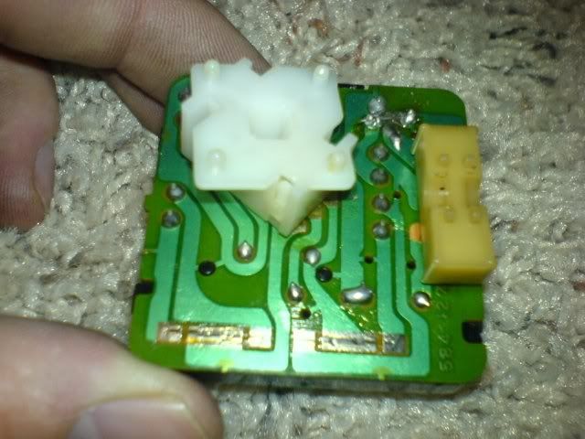

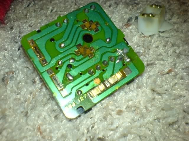

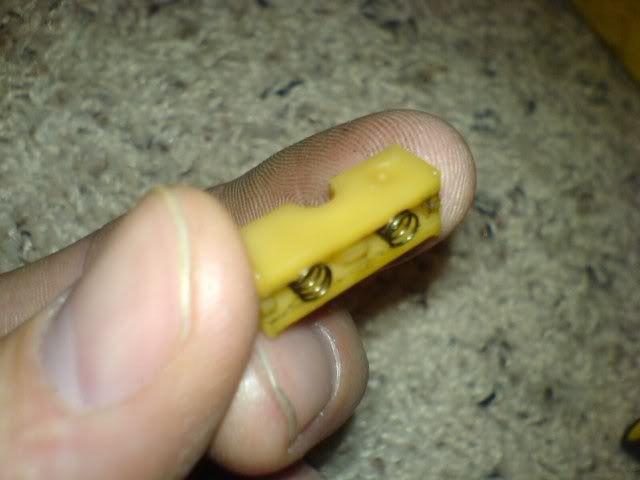

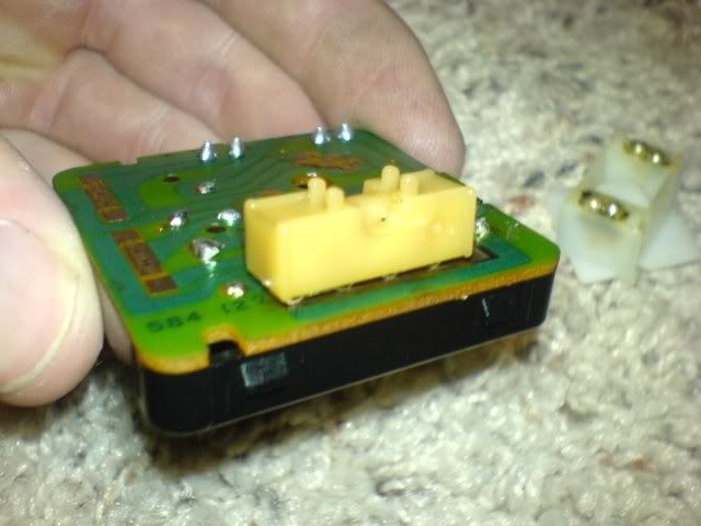

I took apart the actual switch so you can see the internals... I'm sure no one cares but maybe someone will use this information some day lol
