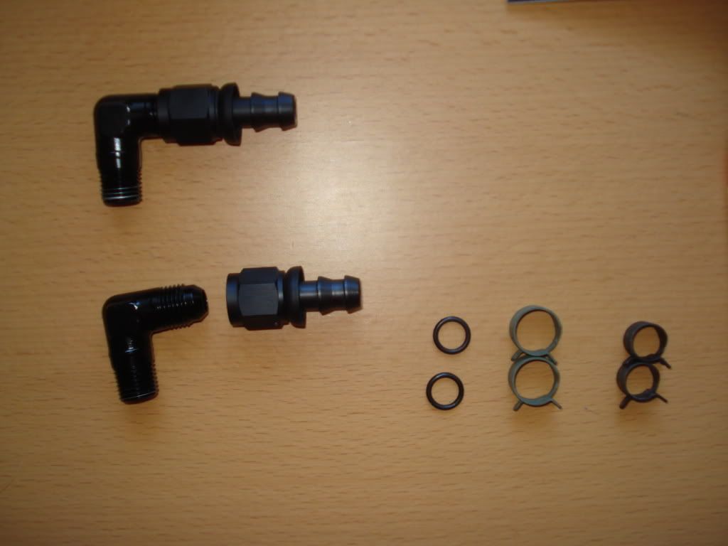

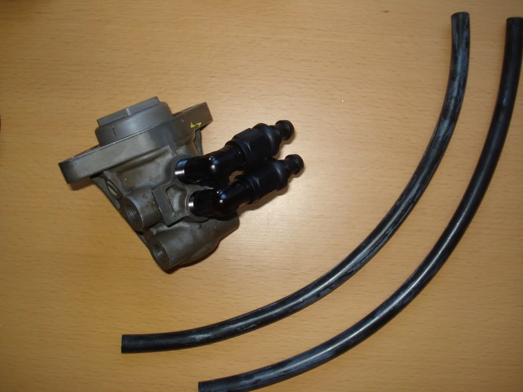

So...IMACHU2 has posted pics of his plan to relocate his brake reservoir and it got me thinking that I'd like to do that too. But he's using a 323 master(which is the same as an RS master btw) and I obviously have a GS master and his list of parts don't work on this master cylinder. The problem is that the ports are different...
So I went and got these, 1/4" NPT - 6JIC 90º elbow and a JIC-Push on hose adapter, a package of OEM style hose clamps and a couple of little o-rings (3/8IDx1/2ODx1/8thick).
Basically the NPT almost fits perfectly in the ports on the MC so I just drop the o-ring in there, push the fitting down hard and give it a quarter turn and the threads bite into the MC just enough to lock it in there. When I actually go to do the installations I will use some epoxy to ensure that they stay in place. IF a guy wanted to there is probably just enough material in the MC to cut a tiny bit of thread in the port with a NPT tap, but I don't think it will be necessary.
Then I'm going to run 3/8" polyurethane (chemical resistant for the brake fluid) vacuum hose to a RS/323 reservoir because the GS reservoir has tiny little nibs on it that you can't really clamp a hose on to whereas the rS/323 res has nice nipples with hose bumps. I'll have to stretch it over the hose fittings on the MC but it'll fit the res nipples nicely.
Total cost will be about $40 and then I'll be able to put my nicer KL31 TB on there with the stock linkage and not have to worry about hitting the brake res.

Lookin' good! The 323 / RS Reservoir looks like it was made for relocating.
Finished mine tonight. Turned out I did not need the hose clamps with the Wilwood hose. The fitting is a push-lock good for 250PSI with no clamp. No pressure, so no worries. The Wilwood hose, like the real push-lock hose needed to be cut off the fitting to remove it. (tested it, it was not coming off). The hose fits super tight on the reservoir side too, but I will likely put some factory style clamps on it for added insurance. The fake fitting style clamps were to cumbersome for the reservoir side.

Yeah I was just looking at that in your log. I wouldn't worry about clamps except maybe for the looks. I would probably adjust the bracket so that the float is level but I'm nit pickey on things like that. Also I am going to try to locate mine so that the hose runs steadily down to the M/C...but again...nitpickey. I grabbed the reservoir off the MX-6 I was tearing apart yesterday and it's the same as the one you're using. I held it up to a GS strut tower and it looks to me like on the MX-3GS the M/C is a little lower in relation to the strut tower. But I think I'm going to build a bracket and hang the res right above the M/C by the same studs on the booster that the M/C bolts to.
