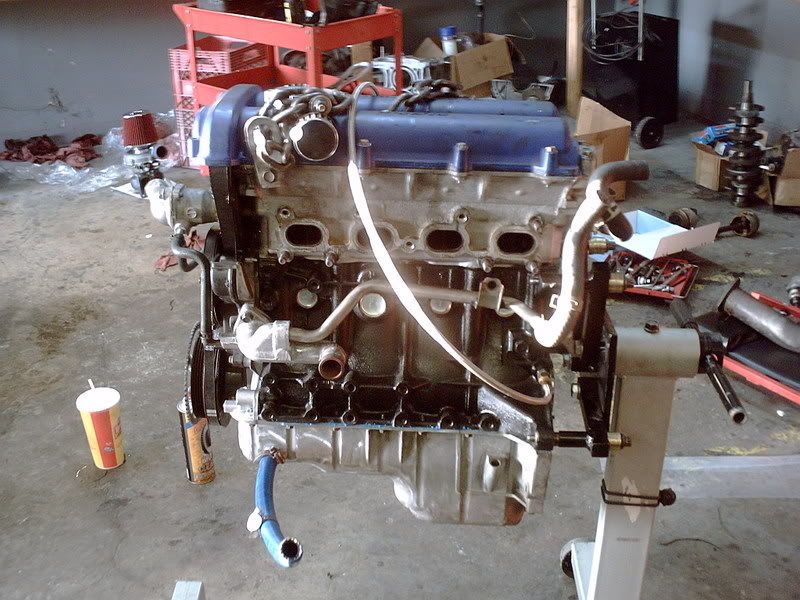

this is an old block of mine that i throw out the bearing causing rod knock. i gave it to ric and he did his magic anyways.
notice a oil supply to ur right along with a oil line that what i mean by getting a oil feed in front of ur BP..
that bottom end was once in my MX-3 and was them converted to a RWD miata BP..

ok so i will have to add the oil return by drilling in to the oil pan . Is there a spot like on your motor in the pic that i can get the oil feed from?? I hate drilling or doing any thing to aluminum but i guess i have no choice and by the way limegreen i watched the video you have and your car sounds sweet what you running for pipes and do the cops ride your a-- im going to be driving my car every day and so will my wife and yes i have lots of trust in her cause she will probly drive it more than me lol

the pic of that engine is for a mazda miata which is RWD different setup as u can tellmaine_mazda_bp wrote:ok so i will have to add the oil return by drilling in to the oil pan . Is there a spot like on your motor in the pic that i can get the oil feed from?? I hate drilling or doing any thing to aluminum but i guess i have no choice and by the way limegreen i watched the video you have and your car sounds sweet what you running for pipes and do the cops ride your a-- im going to be driving my car every day and so will my wife and yes i have lots of trust in her cause she will probly drive it more than me lol
i have pic that can help u but i seem to have a error loading them up on photobucket thats pissing me off.. damnit.. not u the error.
