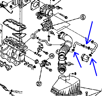

What id like you to do is get some electrical tape and better seal these
indicated spots on your intake.
If you have a CAI like I do then ensure your lower throttle body connection to the intake is well sealed. I re used the old parts from the stock rubber intake and the hose is connected by a plastic male-male joint (assuming a hose is a female).
Try that and let me know how it works, I was messing with mine and it seemed to eliminate the idle up down when I brake.
