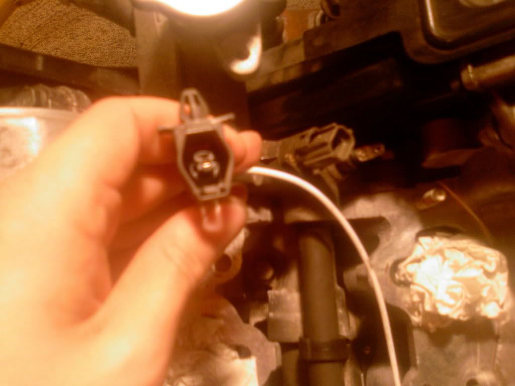

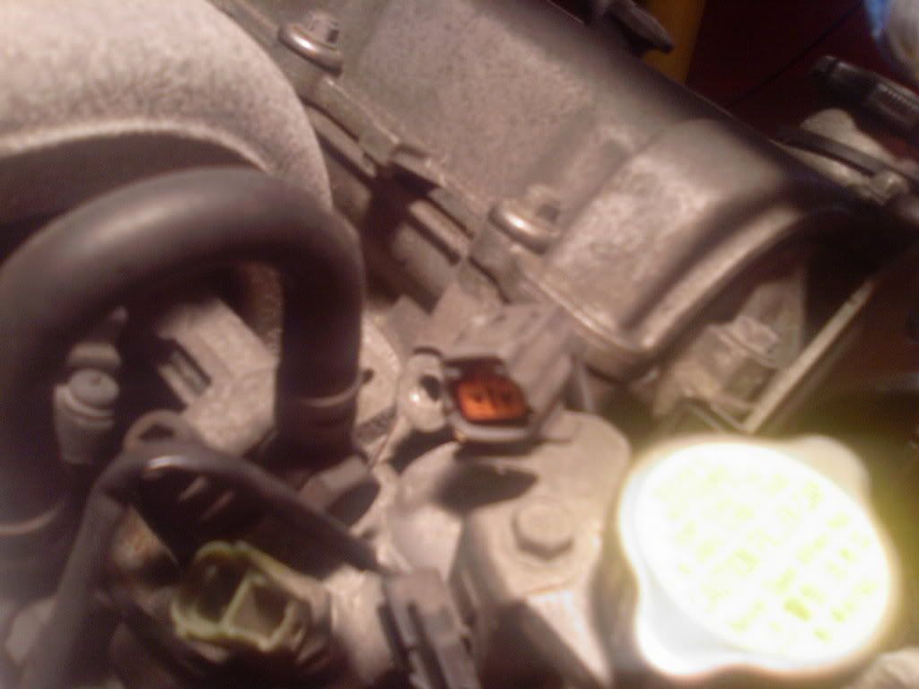

From my KLDE I have one connector (diamond shaped) with one wire and from my k8 I have another connector (square shaped) with two wires.
I know the knock sensor is just a microphone that needs a stable voltage (2,5v I've heard) and it makes diffrent resistance accuring to the sound of the engine witch then again makes a vibrant voltage for the ecu to manage.
To make this happend we need a voltage supply from the ecu (could bin earthed in the ecu and the voltage from another location, but I don't think this is the case) and the sensor earthed some how.
I think that the main difference between these sensors is that the one with one wire, the casing on the sensor is earthed. The sensor with two wires gets earthed another place.

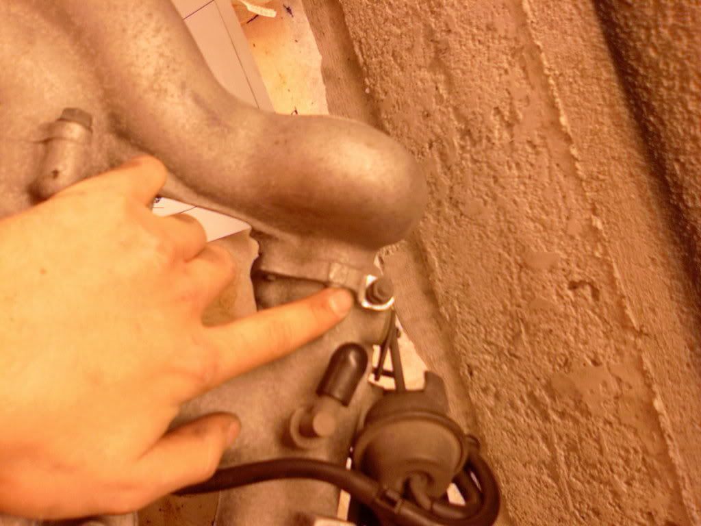

I could be on deep water if that sensor got its earth from the ecu, because it would then probably be listening on the earth instead of the +voltage. But I managed to measure that one of the wires is earthed on to the engine manifold (even when the ecu and all the ground wires where removed, a lucky shot).
As to this I belive I can just switch the connector over and connect the one wire in too the right spot on to the two-wire-connector, not doing anything with the earth.
As a more safe way to go the wire up to the diamond shaped connector has an outer shield that is connected to earth. I could put this in as an earth to the two-wire-connector as well..

Now I have switched to the sensor from the k8.
The reason why I would like to use the already fitted from the DE is that i had mounted a lot of stuff over it including all the belts. I should have thought of it earlyer :)
It seemed like I could use the one from the DE but it had one wire less. The extra wire from the k8 did go to the ground, but did not have the same function as the shield in the cable from the DE.
It would proberbly work, but in case not, it was by far easier to switch it now instead of when the engine is in the car.
