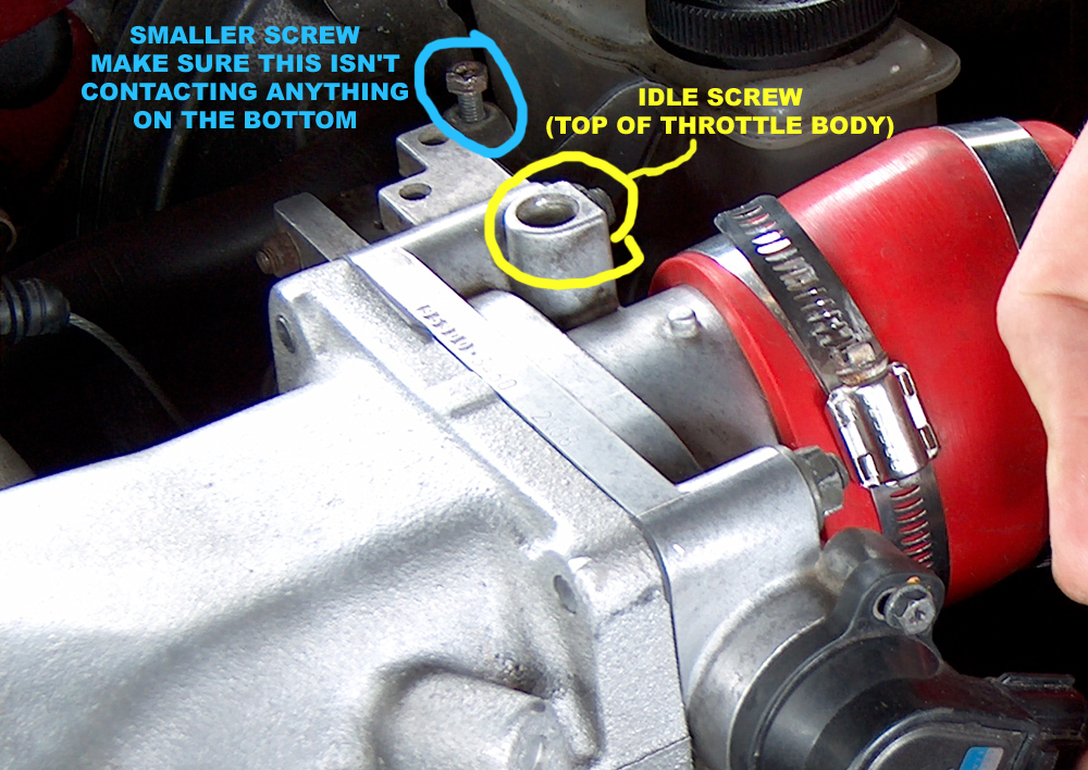

u can low it or rise it.... the thing so u can change it by the throttle body all u need is a flat head screw driver n turn it 2 the left 2 lower ur RPM n if u turn it 2 the right ur RPM 2 up..... make sure u dont go 2 down if not ur car is gonna feel funny..
http://www.supermotors.net/getfile/1766 ... screws.jpg
go there n its the yellow circle.....
