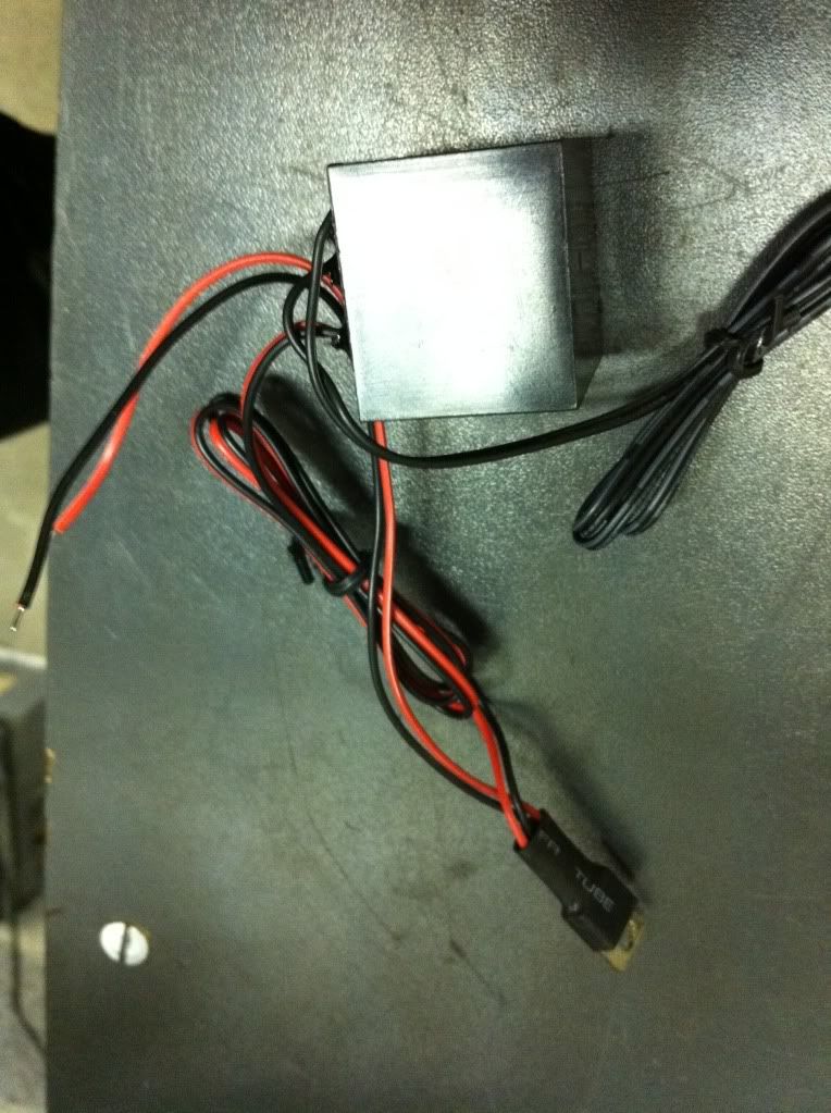

Do not dim your glow gauges by varying their source voltage, you'll fry them.
The inverter needs 12v all the time, you dim it by dimming the inverted signal, which usually comes with the inverter.

Here is a picture of my inverter
