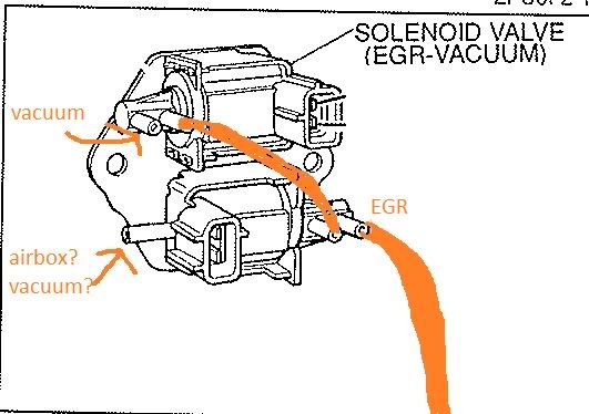

vacuum routing for egr solenoids:
to test your wiring/sensor you need a voltmeter. what i did was verify the voltage on the power wire (with the engine running and wires spliced and exposed). if i remember right it should be 5v or 12v. now hook up to the signal wire and suck on the vacuum hose going to the egr. with the valve fully open (sucking) it should read 5v (if i remember right). when you let off the suction it should go down to 0V or close to it. the Voltage output should be liner with the amount the valve is open so suck in and out and play with it for a bit and verify its reporting properly. if its working hook the egr vacuum line back into the solenoid.
