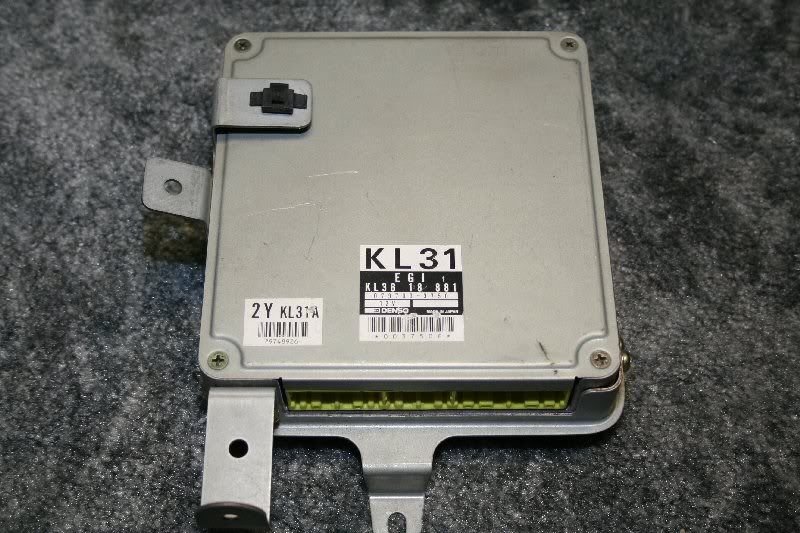

Yes, you can run a KL on a K8 ECM. If you want to go that route, you also need the JE50 VAF from your MX-3, and a distributor matching the ECM (T0T57071 for 92/93, the ugly 94 style, or the T0T57271 for 95/96/97)
Next you can run a KL01 ECM from a KLDE equipped car, with a KL02 VAF, and again a matching distributor.
And then ideally you can run a KL31/36 ECM with a JE50 and a matching distributor. This is the factory setup on a ZE.
And then in a perfect world you'd just run aftermarket engine management, like Megasquirt.

I'm using a 2.5l klze with stock everything besides exhaust and airbox delete. I have so little time, I haven't even put an airfilter on it (I know I'm stupid). Stock ecu, vaf, disty. I have no oxygen sensors as well. It stuttered a little at first during moderate throttle applications, but after I replaced the sparkplugs and set my timing to the highest recommended in the manual, it runs pretty darn good. Its got lots of power, spinning in 1st and 2nd under heavy throttle. No stuttering at all anymore, only thing that I notice is a small miss. That could be the cracked sparkplug boot in the #3 cylinder, lack of O2 sensors or just from running mega rich. Other then that it's great!!
I am eventually going to get a megasquirt and widebands...and airfilter. I'm going to have it dyno tuned as well.
After all of that I'll be able to say either wow...I was lacking serious power or meh..it helped a little. As far as my understanding goes i should be around the 180hp area, considering the larger exhaust and catalytic delete, oh and non restricted airflow. I guess 17 HP will be noticeable unless I'm lower then my estimation of 180.
My point is use all your stock stuff and see what happens, mine with the few tweaks I mentioned runs great, others have not been so lucky. Hope this helps, goodluck!!
