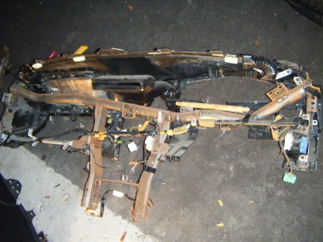

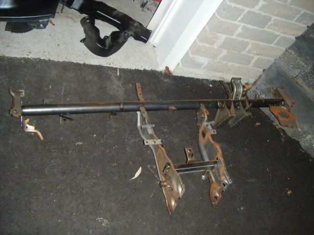

I just did this swap today.... I opted to do #1 with changing the rebar to the 93 style and changing the wire harness over since I wanted a safer way where it all bolts up!   I am getting the top pad of the dash Carbon fiberd so I wont' have it in for a week but it IS possible to do this complete swap in 1 day including taking it out of the wrecked car!!

Yea the whole thing!  hmm hold on I will post pics!
My dash B4 the swap!
My dash wiring.... I forgot about all the stuff I added to the car lights and such!.... that was HELL tracing them back and getting rid of it all!
The dash with the 92 style Rebar and wires all attached making sure fitment is good!
The difference between the 92 style rebar and the 94 rebar!
92 Style
94 Style...
92 Style
94 Style...
