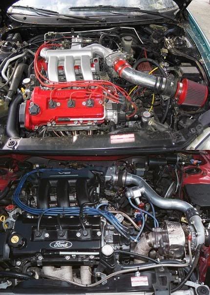

You can use the straight neck klze but I hear its hard because you have to relocate things, do a search because info on how to do it is on here. You can use the manifold off of the k8 but will loose power. You can use the k8 ecu till you find a kl36 or 31. Just do a search and type in either manifold, swap, ecu or search the v6 tech section. Klze's never come with ecu's. You can just buy a curved neck klze if you can find one? Good luck.

Mazda mx-6 or ford probe gt come with straight neck im's
Mazda millenia come with curved neck manifold's. Whoever you buy the engine from depending on which car it came from is what you will get.
But either way you will get a klze with a IM.

:arrow: Here the 2 versions... You should be able to tell which is which... The 2nd one is in a P-GT though...
