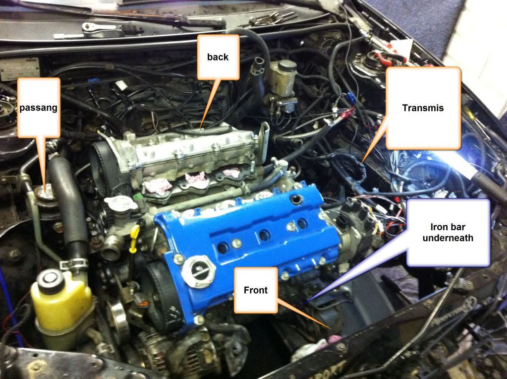

I would like to know what the best way is to uninstall the engine?
The 4 motormounts are all still in there, so is my powersteering pulley, transmission and the bar that runs from the radiator to the shifer linkage.
What should go first ?

I'm confused. You're talking about cross member mounts (tranny mounts) and about engine side mount and tranny mount.Evo_Spec wrote:IMO i would do take off the whole power steering pump (leave it in the engine bay) then undo the cross member mounts (tranny mounts), attach the engine hoist,then the engine side mount and tranny mount and pull, assuming you have the heater core hoses and wiring harness and all the miscellaneous things already detached.
So
1. Ironbar
2. back mount
3. front mount
....engine hoist
4. passenger mount
5. tranny mount.

i ment front and back, i call them xmember mounts cause they're connected to the xmember lol
