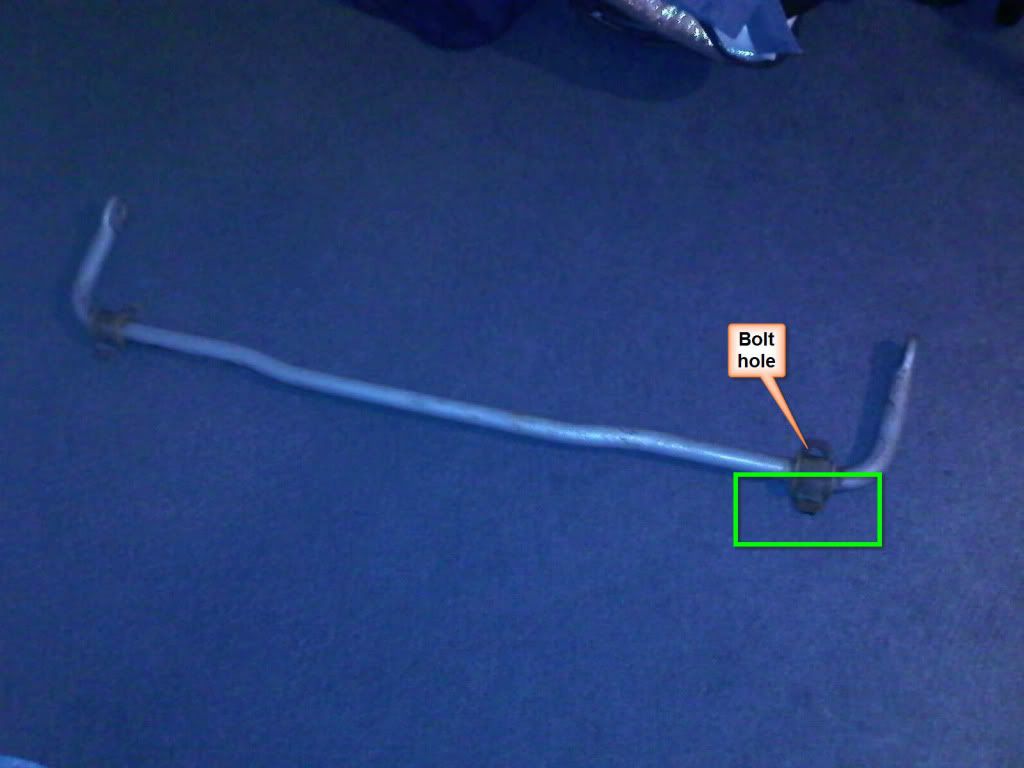

Oeeefff.... after spending 3 hours with my dremmel under the car I managed to cut all the bolts ! (well, all... only 2 off the end-links)
Now I've put the swaybar on the car, but when using the regular bolts I started to wonder something.
The hole in the picture is used to put the bolt through.
Other side seems to be able to slide into the chassis.
But when I slide the little lip into the chassis I can't put the bolt through. Is this normal ?
Re: Swaybar uninstallment
Well it's going to be tight. you slide the part into the chassis and then it will probably still be at an angle (not flush with the bolt hole) but the bolt should be long enough to just get it started and then as you tighten it, it becomes flush...
