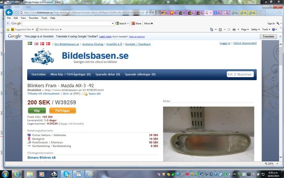

I have spent a lot of time looking for OEM clear indicator lamps (stanley 041-0687L and Stanley 041-0687R) for the Presso.
I landed a used set ex a Mazda 30X from Oz for A$40 plus P&P.
Another good source is
http://en.bildelsbasen.se/?link=item&se ... d=10570629
starting at about $US 17.50 plus P and P.
Might be of interest to an MX-3er.

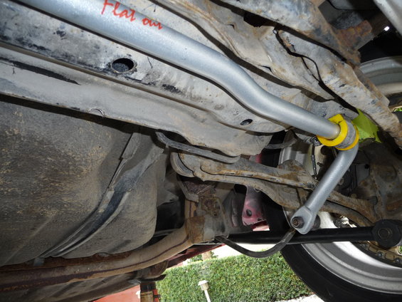

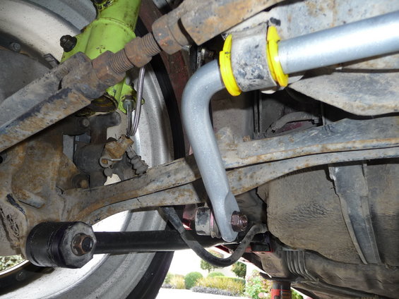

Re: 1993 Eunos Presso - Wjiteline Rear Sway bar
Eunos Presso HI-XS, KLZE, KL47 IM+TB, MX6 LSD box OEM front s/bar, Outlaw IM+TB thermalbloks, lightened K801 fly, XTD Stage 3 clutch & cover balanced to f/wheel, mbolin tranny saver , short shifter, SRD shifter bushings- H&R Springs and Koni inserts, MSpeed engine mounts, SS brake and clutch lines, PRM CAI, Whiteline rear strut and swaybar, 7x17 Konig/Maxxim Fourteen rims, and stuff.

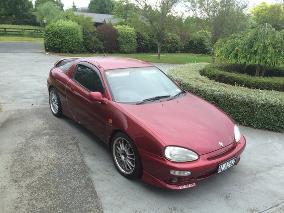

Re: ProjectB10 - 1993 Eunos Presso HI-XS Special Edition
The red one is not road legal at the minute. The next step is the engine and gearbox upgrade. The engine is back from the engine builder....and I am recovering from price shock!!!WhiteFinish wrote:Nice update.
Did you decided to drive the red one instead of the bordeaux?
When finished it will be used as a track day car. Its only travelled 127K kms, the panels are all straight but the paintwork is dead. Its just a project and very much a work in progress.
The Rose mica one has 107K kms and is in mint condition, fully road legal and "driven" in the weekends LOL, Its lurking in the garage behind the red one in the photos. The parts car is parked outside on the grass.

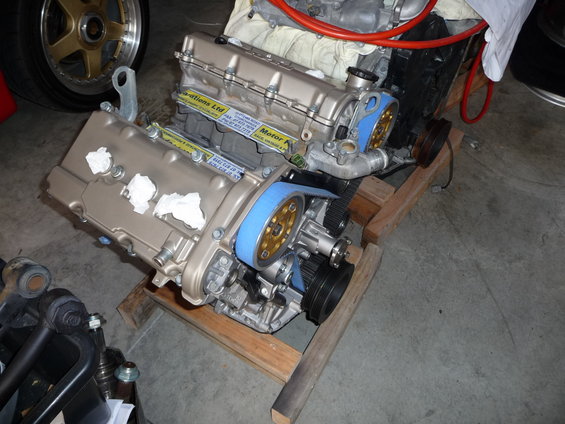

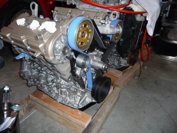

The cause of the distressed walletprojectB10 wrote: The red one is not road legal at the minute. The next step is the engine and gearbox upgrade. The engine is back from the engine builder....and I am recovering from price shock!!!
That engine looks delicious! Hope the everything goes well getting it re-installed.

beautiful motor, i hope all the internals are well. I would highly recommend a manual TBt though unless thats a new oem mazda tensioner.

Yes its an OEM tensioner.Sleeper6 wrote:beautiful motor, i hope all the internals are well. I would highly recommend a manual TBt though unless thats a new oem mazda tensioner.
The short block is new and never used. It has been modified in this build up; KJ-ZEM rods and WISECO 11.5 pistons and the whole short block assembly (crank pulley to FIDANZA flywheel/clutch assembly) fully balanced. That balancing exercise produced some interesting measured results...the lesson in my opinion is that changes of that sort mean that the entire rotating assembly must always be rebalanced if non OEM or different OEM parts are introduced....even the clutch cover was modified (small amount of weight removed at one point on the cover) as part of the process. Its an added expense and you need to be careful that the shop involved has the equipment and expertise to do the job properly.
The ZE cylinder heads have been rebuilt, refaced (with reconditioned HLAs etc) with KL-DE keepers and retainers using INTERPREP valve springs and using NA "Triflow" reground cams.
Everything else is new; oil pump, water pump etc.
Ohh yes ..the baffles within powder coated cam covers had to be disassembled and cleaned/bead blasted internally as the builder found that they were full of used blasting media and other crap that potentially held the risk that that material would be dislodged and carried over into the engine lubrication system over time.

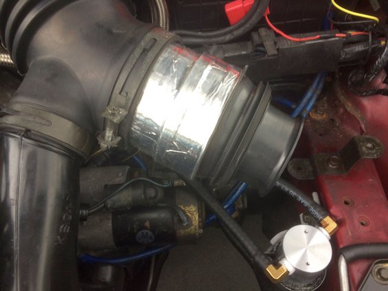

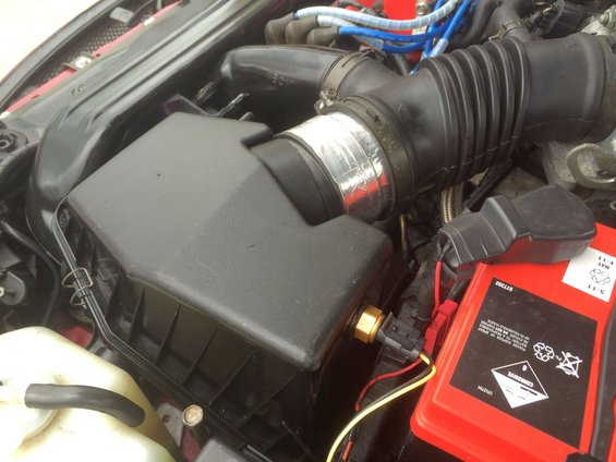

I fitted a MX-3 PRM CAI kit along time ago to the Passion Rose car. I would guess it was at least 12 years ago. It was lightly hacked around when the ZE conversion (using the Eunos 800 IM) was done and again when the MSPNP was fitted and the airflow meter deleted. The Eunos 800 IM has the same general form of the K8-ZE IM but is about 25mm longer (closer to the radiator) at the point the TB attaches to the OEM air tube.
I was never really happy with the set up and made up my mind to remove and return the OEM air intake tube and air box and all the associated bits and pieces to the rightful place. I also wanted to retain the "velocity stack" shaped portion of the old airflow meter (the first section that inserts into the air box), install a K&N filter and at the same time fit an air/oil separator (aka catch tank) from Conceptual Polymer (http://www.conceptualpolymer.com).
I cut the front section off the airflow meter at the OEM assembly joint (glue??) line
Then attached it (contact adhesive) to the PVC over which I had slipped a PVC socket to provide a wide enough face to both match the air meter part and give the contact adhesive plently of contact face. I then overlap bound the join with rescue tape (fabulous stuff) to a short length on 90mm diameter PVC pipe. The internal and external dimensions/diameter of the 90mm PVC matches the size of the OEM air meter piece perfectly and the internal size is huge compared to usual 70/75mm pipe dimensions common in aftermarket CAI setups.
The intention was to start with an overall length for the hybrid (inlet section and PVC pipe) equal to the end to end length of the OEM air meter. I knew that would be too long but it gave a safe start point. I overlap wrapped it in 3M Aluminium tape to hopefully provide some temporary reflective protection against radiant heat soak as the PVC tube has a wall thickness of only about 2mm.
to be continued....
to be continued....

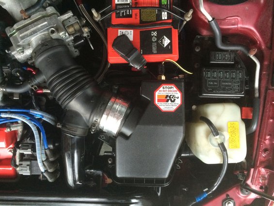

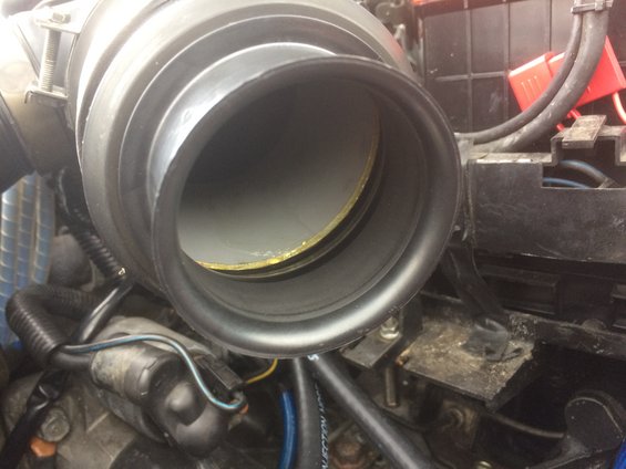

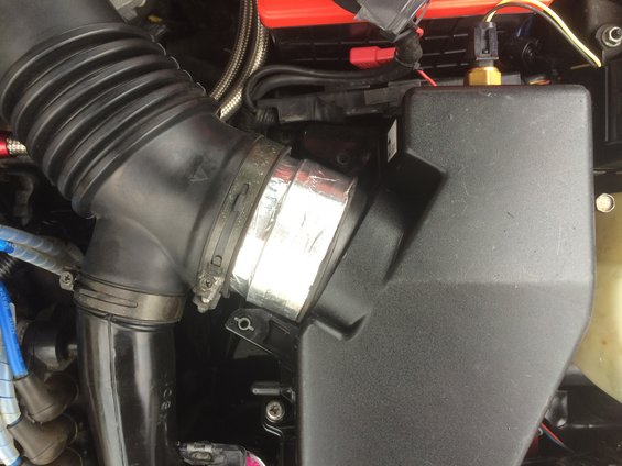

The alignment in the original mounting points of the combination of Eunos 800 IM, K8-ZE air tube, my air meter delete piece and the air box was a no go.
The Eunos 800 IM size difference slightly changes the angle at which the airtube etc matches to the airbox. My solution was to removed 15mm from my guestimate of an overall length for my air meter delete piece. When all the pieces are assembled in the factory locations there is still a small separation angle but there is still enough contact between the rubber seal on the nose of the air meter piece to provide air filtration security.
You can see that the separation of the mounting face in this picture.
Mounted the air temperature sensor for the MSPNP in the top of the filtered air part of the airbox. I used a 5/8in internal diameter grommet to match the diameter of the sensor and the grommet is mounted in a 25mm hole in the back face of the top part of the airbox.
And a top view here
I used a K&N OEM sized cotton filter
To be continued.....
And a top view here
