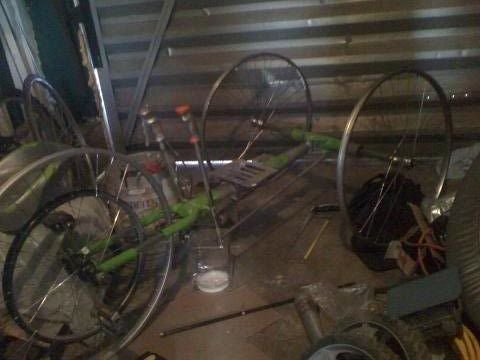

Weird. Reminds me of this:
It's a trike I built for a Burning Man campmate. if you look close, you can see that I laced a larger rim into a smaller one for the front wheel.
Re: MPG after wheel/tire swap
Post by Josh »
That's pretty cool Must have been a pain to get it straight.
fowljesse
Post by fowljesse »
It actually wasn't bad, Josh. I used to be a wheelsmith at a bike shop.
