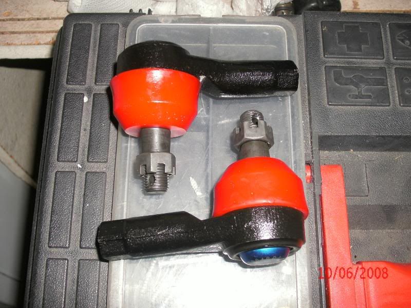

I bought a set of new Zx2 tierod ends for my new rack instead of the mx3 ones b/c I noticed unlike the mx3 ( which are grease filled boots that are none replaceable) the zx2 rod ends have removable boots on them which ES makes poly boots for them and man to they look nice and alot stronger then stock by far. for 2 new TRE's and poly boots I payed $31.99 /w a 90day warranty. ES part # is 9.13101R
And for questions they are the same size/pitch/thread as mx3 stock ones M12x1.25.
Will have pics up soon!

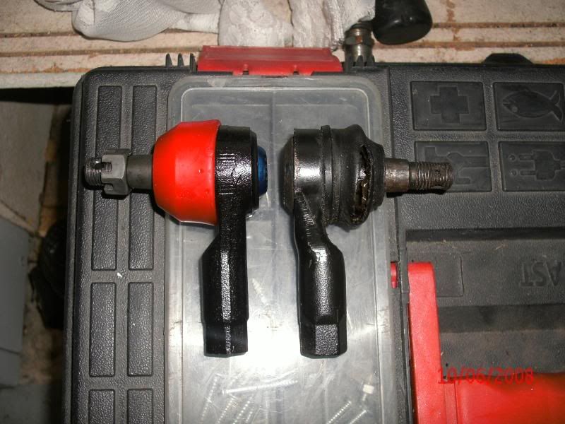

RIGHT: Mx-3 Stock Tierod end Left 99' ZX2 Tierod end /w ES Poly Boots

When you say "Stronger than Stock" are you comparing them to your worn-out ones? Or do you have a new one you are comparing side by side?
How are you comparing them? Just by feel?

I think he meant that the ES Poly boots are stronger than stock...which they would be.

the ones on my car I took off next to the pic above only had less than 5,000 miles on then. So yes way better/ stronger feel then New oem mazda ones. The best part I like is you cant rip the boot easy taking then on and off like factory ones.
