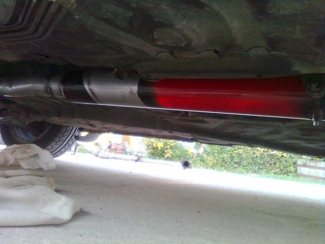

This is what a KLZE thinks about Cherrybomb's high temp finish:

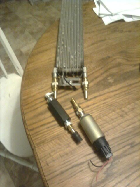

Bought everything but the lines + clamps for the priming/cooling system.
Not bad for $50. 5/16 transmission line will be the hose. I'm not worried about the hose, because I slid a little section of hose onto a fitting, and I can't get it off, even without a clamp.
That big black thing is a check valve, so the pump can push into the oil system, but the oil system won't push back.
I am going to run the pump in two modes, automatic, where it uses the stock oil pressure switch as a ground and automatically turns itself off when the OPS sees pressure (will flick on/off lots) or manual ON, where I just have it on a toggle. Looking for a SPDT switch for this feature... fused 12v centre pin, one pin chassis ground other pin OPS (or relay using OPS as trigger ground, depends on draw).
The cooling pump will be strictly manual.
The only issues I'm forseeing is keeping the oil level in the pan constant. The check valve, and the internal check valve in the pump will keep the pressure system fine, (aside from whatever is in the hose between the pan and the pump, like 1/4 cup)
The cooling one will be interesting though. If the check in the pump is weak, thats a lot of fluid that can flow back, perhaps a litre or so.
I am going to tap the pan in such a way, that if one of these systems is to puke all the oil onto the ground, the level in the pan will not fall to an unreasonable level. (engine still draws oil when its off the stick).
I have a spare oil pan and pump, so I can measure exactly where the level sits in the pan, and weld the bung on accordingly.

Thats a really cool picture of the exhaust !!

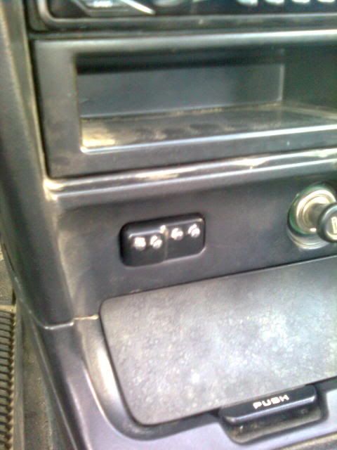

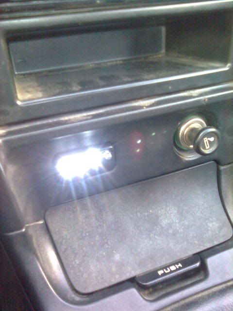

Got sidetracked today and did a little mod I've been thinking about for months
Left to right,
power indicator (lost my switches, but once I find them this will be important
neutral indicator
VRIS #1
VRIS #2
contemplated throwing in purge, IAC, FPR, and every other solenoid on the engine, but even I thought that was excessive... but I may do it just yet
Left to right,
neutral indicator
VRIS #1
VRIS #2

So wait.... What do those lights do? And how did you make 'em?

lol I like the VRIS particularly! VRIS kicked in YO!

Kool beans! So they are like indicator lights for the vac system, so you can keep an eye on the little buggers. Beats the hell out of "the paper test"

I love the small cooler you got for the coil, and the LED idea is great!
