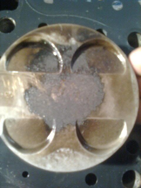

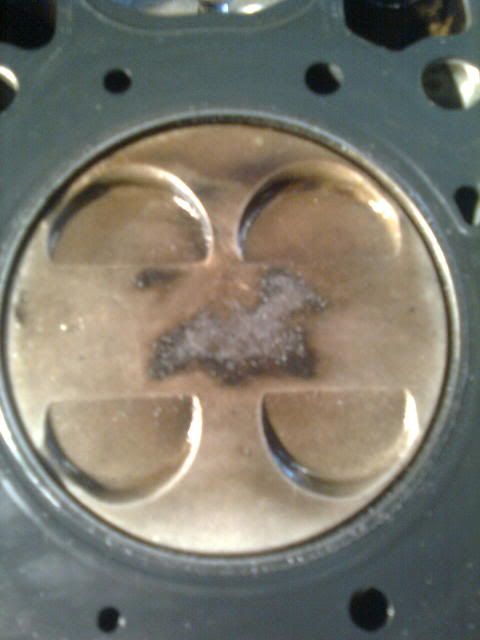

Machine shop said #5 was waaay out (after the polish, and there were still gouges on the top) and they want to check out the rod too, make sure it wasn't spun too large.
So I had to remove the rear head (which I was trying to avoid)
HG looked mint. Everything was mint. Cyl walls are still a bit rough, she's still working in. Piston rings are nice and free.
But I noticed some strange combustion patterns...
Cyl 1
Cyl 3
Cyl 5
Now, I take this to be carbon build up... It would allow lots of extra oil past at this point, that could be it.
Why are they unequal?

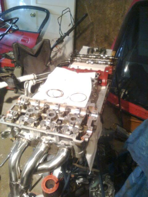

here's the parts that came off.. I can tear down a head in 10 mins...
