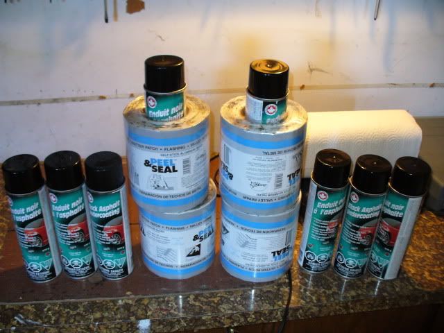

Soundproofing material for entire car <$100 CAD?
Check.
The undercoat was on sale... $3 a can
Re: Ryan's Final Build
Where'd you get your Peel n' Seal?
Lowe's. My bro and his wife made a black Friday trip. Only an hour or two drive for us.
Do the undercoating in a well ventilated area, it stinks
Also the cans tend to gum up if they aren't held almost perfectly upright

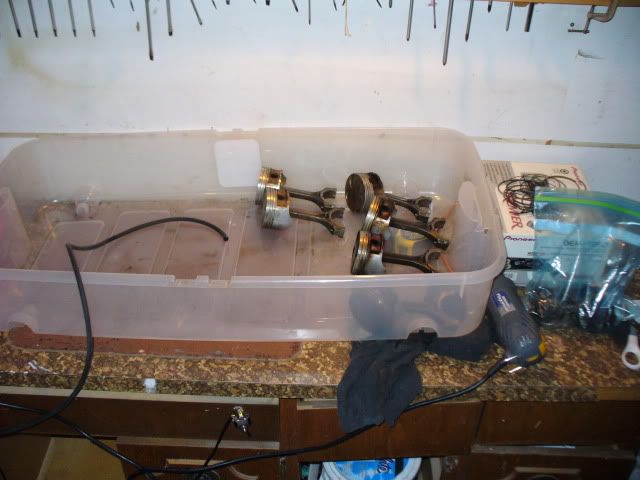

My home made varsol tank:
My neat little kit for my dremel ($12!)

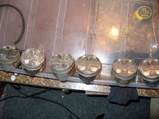

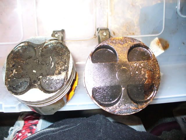

WTF is with this one piston?

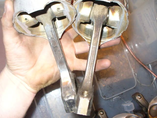

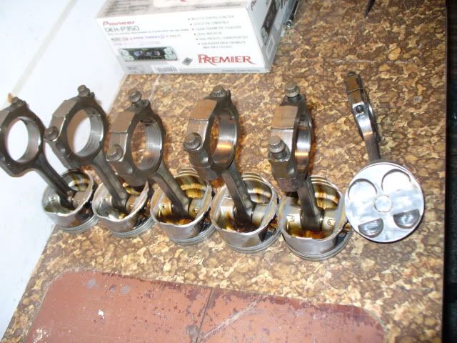

Some rod work:
Long day over:
I had to debur ALL of the pistons. The bright eyes that sent them to me sent them all just tossed in a box with an insulting 8"x8" sheet of bubble wrap, all disassembled, first to Cali by mistake, then to me. I've still not decided if I want to throw them in the garbage yet. they're pretty bad... but IDK, they might be salvageable. Either that or this will be a short lived ZE.
Some rod work:
Long day over:
