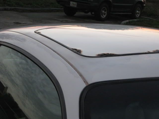

Ok, roof canker is gone, and all the paint is polished. Will post pics, maybe tomorrow.
Found a few not so nice surprises with the paint. Not all of it is original, and the idiot that did the paint job couldn't have done a worse job. This car is definitely in for some new paint in the future.

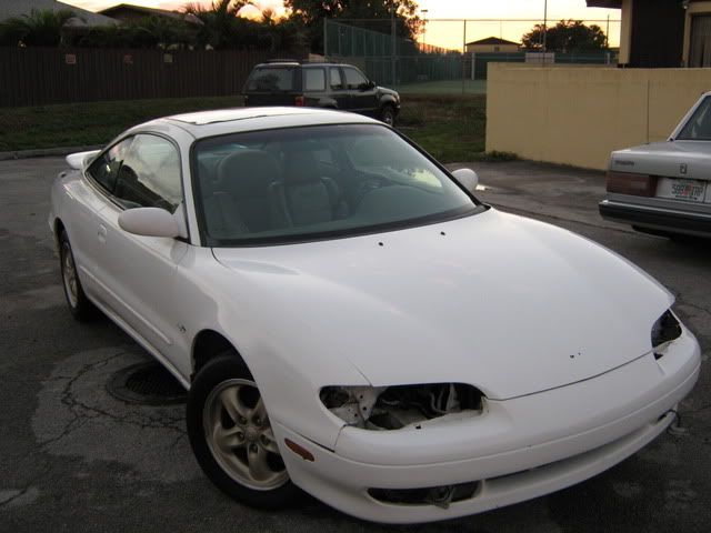

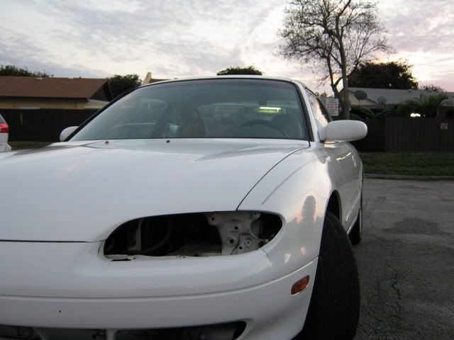

Ok...pics.
Here's 2 different angles of the car, after being sanded down with 1000 grit, polished, and waxed with Meguiar's "Mirror Glaze" #7 and #26.
Now I'm working on the headlights and foglights.
And here's a view of the "former" canker.
Now it's starting to look like something...
