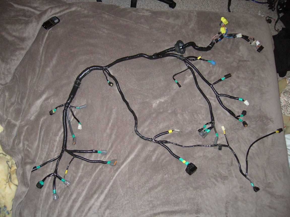

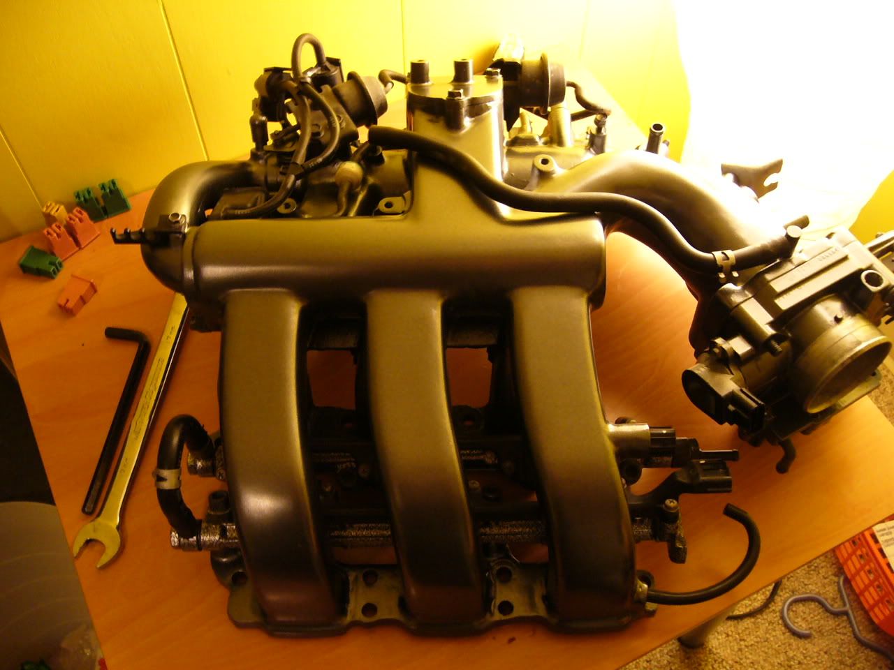

So after the swap the car was NOT running, it would start one time out of like 40 try's and when it ran fuel came pissing out. There was something wrong! Ends up 2 injector orings were messed up causing my issue. So I swapped in a rail from a DE motor, car would still not run, we tried EVERYTHING and I mean EVERYTHING, I was very upset and still am at this point. I had it running for one day in the last 5 months on a 93 harness and ecu, and the car ran but not well. NO VRIS, NO cooling fan, NO Power, NO idle. I was pissed, the horn would honk if you took off the coolant temp sensor or when u switched the car off. The horn would BLOW if the cooling fan was supposed to come on too. RARG.

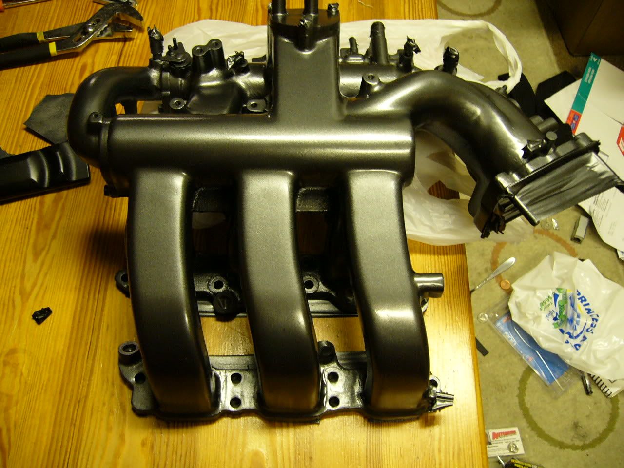

So I think it is the harness now, so I have since removed it and redid the harness and found that the 2 connectors to the purge solenoid behind the IM were melted together. I hope that it fixes the issue so that the car will run! I have also redone my intake manifold cause the polish looked lame:
Remaned harness:

Re: solo_ryder - 1994 MX3 GS-ZE
very nice IM i want one like that... was it long to do?

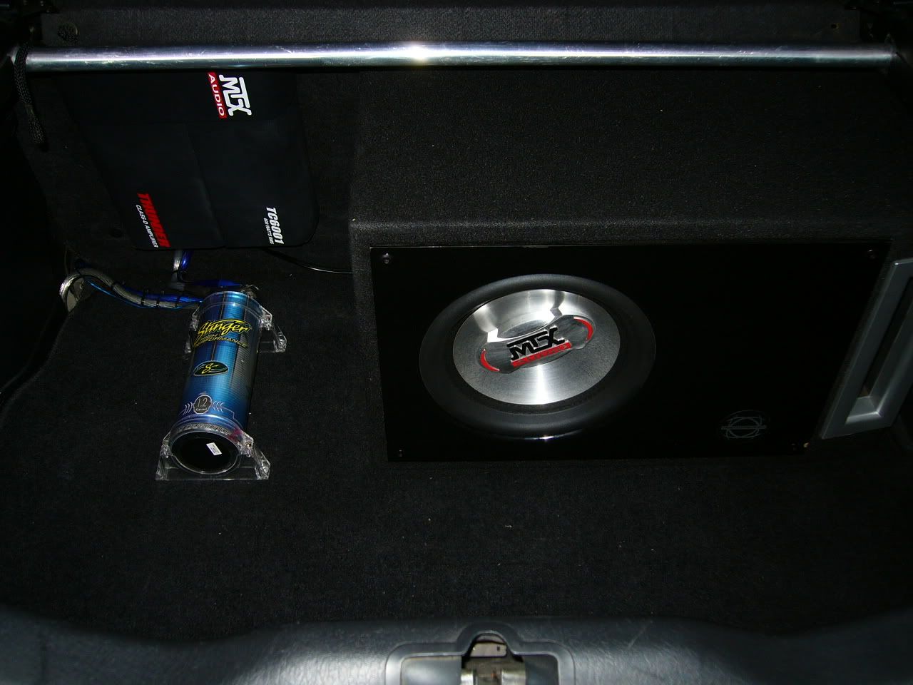

Decided to install my updated stereo yesterday. Consists of
MTX TC6001 1800w amp
MTX MXS1004 sub 10"
Stinger 1.2 Farad cap
Pics:
MTX MXS1004 sub 10"

Polishing is a b----, I will never do it again. Painting took like 10 minutes. Its all in the prepjohnmx3ze wrote:very nice IM i want one like that... was it long to do?

nice clean, and low! i like how you grinded off the mazda on the valve cover, really clean. its almost too clean.. color is spot on too.

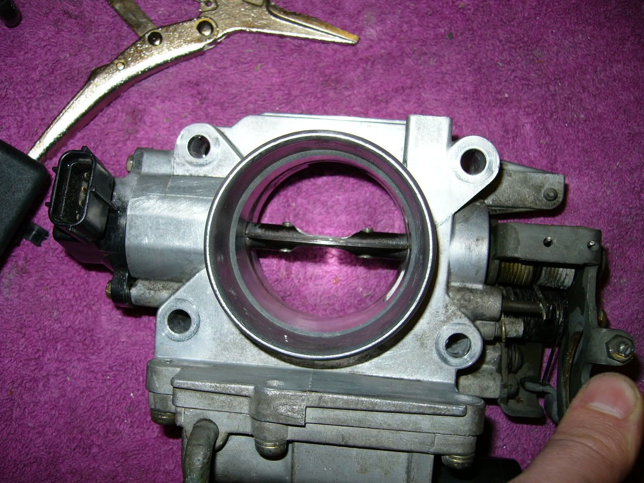

Ok, so small update. I have decided to hourglass my TB as I am waiting for the weather to warm up. Here are some pics of the TB and my bros PGT-ZE motor:

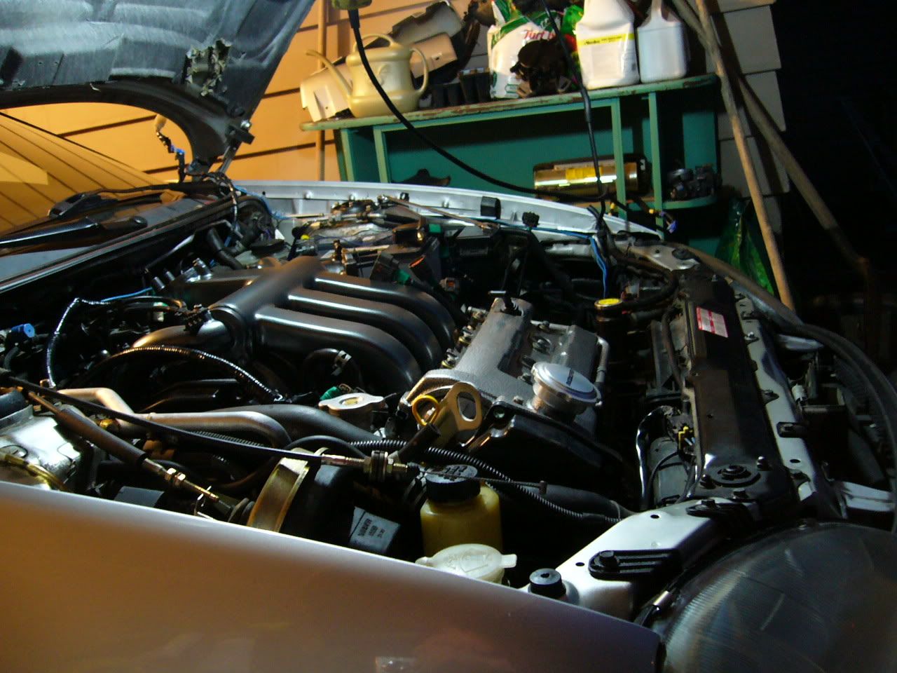

Well did some work today, put my harness completely in and saw the knock sensor had a broken wire. So I repaired that.
I installed my harness, Intake mani and battery. It got dark out so I called it a day. I am missing my FPR so I cannot start the car till I get that. Here is what I did:

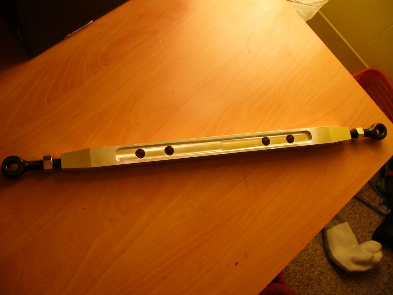

Update. Just got my SRD rep. rear lower tie bar from someone...
Should be a nice touch!
