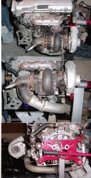

Finally! Heres my turbo set up that I was going to use but I will have to get a smaller radiator because the exhaust housing will hit the radiator. I didn't want to get a different radiator so I tired to make a supercharger bracket by the A/C location but its going to be way to close to the front frame cause I use the A/C braclet and a 1/2 inch thick aluminum for the bracket. I had it all bolted on yesterday and oh yeah its way too close. It will work if you don't use the A/C brackets. I beleive that the probes should have more room than us mazdas so it should fit the probes. I'm thinking about selling them cause I really need some money for some bills right now. Here are some pixs of my car and also the turbo pipings.
[/img]
I didn't get any pix with the supercharger on yet maybe later. Oh its a M45 supercharger.
