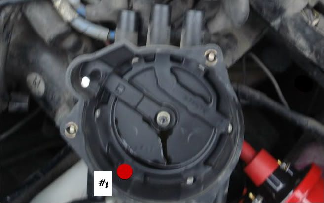

2fazed wrote: ...did tdc and the rotor on the disty wasnt lined up with #1. it goes straight up.
This statement says that the engine is not properly timed. If the engine was timed properly the rotor would be very close to the #1 disty pin. On the K8 disty the #1 pin is on the bottom side about 20º toward the firewall...about 5 o'clock looking at it from the outside. It's at about 7 o'clock looking at the inside as shown below.
If that engine ever ran with that disty it's not the wrong disty. Make sure you are TDC on cyl 1...pass side closest to the firewall. Make sure you're looking at the right pin in the disty cap.
Describe how you know that the timing is correct by looking at the timing belt.
Because all the marks line up. At this point, I don't really trust the previous owner. So I've got to grab another disty to verify. Once I do that, then I'll look into the crank pulley and cams. The rotor isn't suppose to be straight up, it's suppose to be slanted to the left, when the pulleys are lined up, which it is right now. When I say the timing is fine, Im referring to the timing belt side is all lined up correctly.
