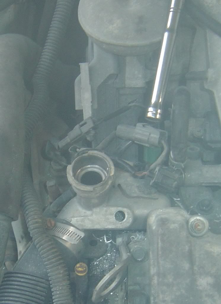

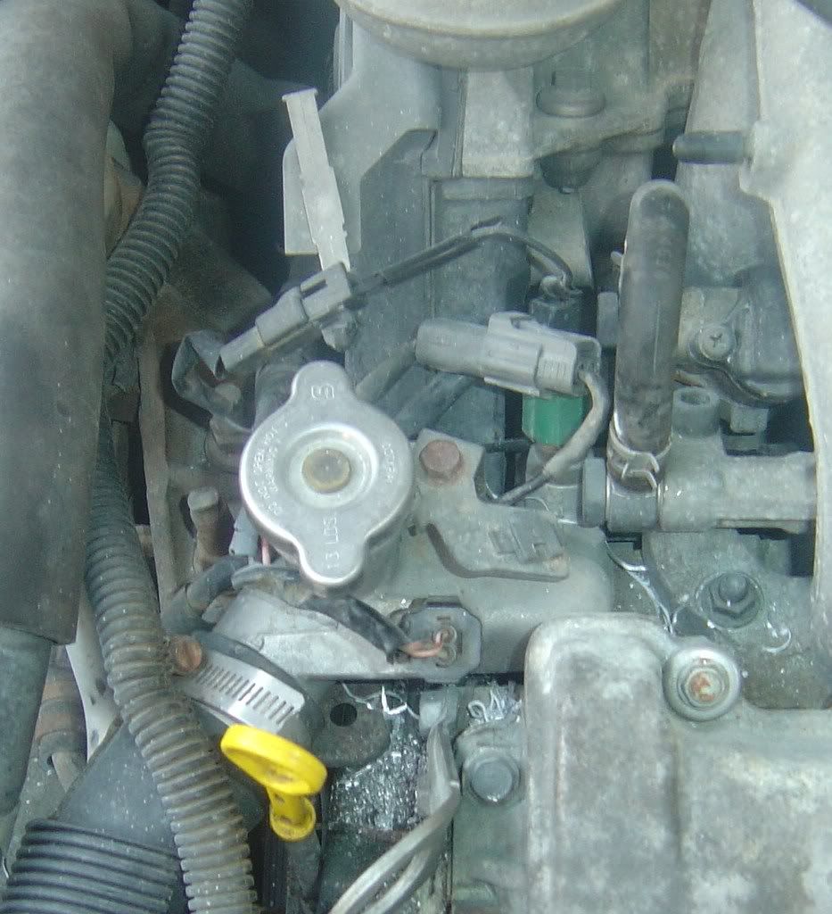

I Finally had to drill n tap a spot out for that missing thermal sensor.
If you guys remember i had a 94 motor in my 92 GS. The wire harness had this dangeling
plug that needed to be plugged into something. That something WAS the other temp sensor.
The car no longer dies and the engine light is no longer on.. IM SO FREAKIN happy.
If anyone EVER has to drill that spot out i have ALL the measurements. (12x1.5)
Thank goodness i had the donor SE here cuz i took the sensor out and used in the GS.
(i also took the dip stick cuz the one in the GS was broke off) Hugs the parts car... :lol:
It took a minute for the car or computer to catch up and understand it was fixed.
I took it for a quick spin and it still did die... But while i was sitting there listening to it...
i noticed the engine light shut off. SO i took it for another short spin around the block.
Didnt die.. so i took it for a longer spin.... didnt die.. drove to walmart and back... STILL DIDNT DIE!

Before:Image
after:Image
finished:Image

You did flush it a couple of times, right (hopefully backwrds, and right out where the hose clamps on, so none of the shavings went into your engine)?

Yes.. i promise i was careful... :roll:
