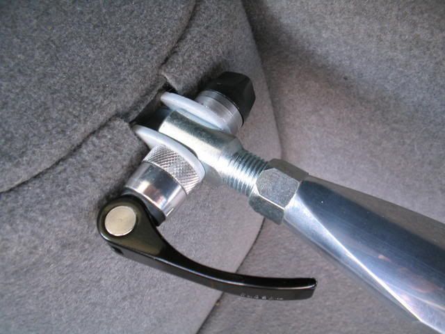

Oh, here's a good one.
It doesn't take the plate off, just the bar! Good idea
also, simple. Just find a quick release that fits in the holes on your bar. Shouldn't be hard...
Checking the internet, some people have cotter pin setups. That scares me.

No, Ryan pinpointed what I meant. Just take the bar itself off, and leave the mounting feet in place under the strut mount bolt nuts. If we could find what he has pictured, it will do the job nicely, and not sacrifice the performance of the bar while installed (theoretically).

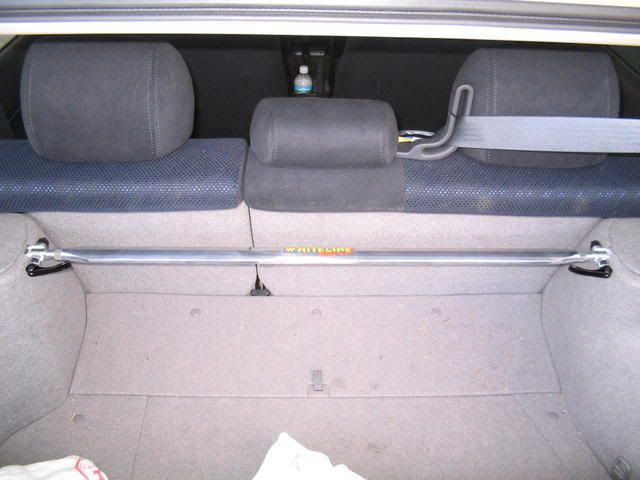

I agree with mooneggs. That quick release is still gonna be hiding under the plastic speaker covers, unless you have a huge hole to access it from the trunk.
I just don't think this set up will work for the MX3
Heres a couple pics from WRX

As far as the tightness affecting the effectiveness of the strut...it really depends on the fit of the pin. That Subaru unit Ukrman posted would work great. I think I will copy that design and sell it to the masses.
