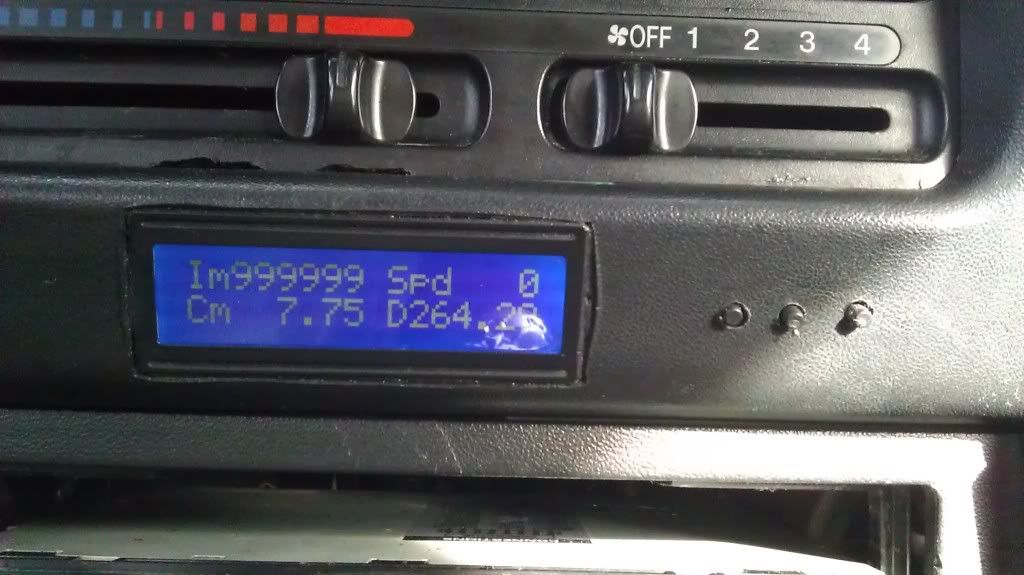

so good news for once. after installing this:
and picking up a kl55 ecu/kl01 vaf ive managed to travel 274km and i still have 3/8ths of a tank of gas left. ive only used the new ecu combo for maybe 100km but my exhaust feels much drier now and it doesn't reak of gas as bad.
if anyone was wondering that screen is a mpg computer. it ties into the vehicle speed sensor and the fire pulse for an injector and can calculate instant mpg/ average mpg as well as a few other things. its extremely useful in picking the ideal gear/ knowing how much gas pedal to use. its still not 100% configured but from what its displaying im averaging around 7.75l/100km.
