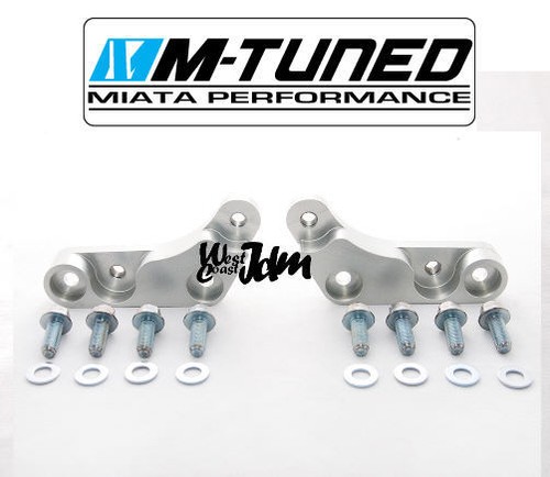

Doing some preliminary research for my brake conversions and with swapping the rears to 02' miata sport rears, it is not worth swapping the calipers over IMO. I can only find them refurbished for about 120 each with brackets I cannot find any in the wreckers so, I think I am either going to make my own bracket, or buy the M Tuned brackets. The surface area is not that much more than the GS rears. The one benefit would be they are a little thicker in the pad department but eehh.
I included the specs below for anyone interested.
Sport rear pads
MX3 GS rear pads
M Tuned Brackets
The fronts are coming as well. I will get them all installed around mid next month.
I am swapping in a 1" master cylinder and 4 piston RX7 calipers with miata sport rear disks, and larger 12" front rotors. :) I am deciding on pads right now. Am leaning towards the EBC's but they are kind of touchy and need warming up but then the Hawks I had were the same way. Probably EBC's ..

Well all brake upgrade parts are ordered and on the way. Hopefully they all will get here by Saturday but will be here Monday by the latest. My brakes will be as followed.
- 1" Milly Master Cylinder conversion
Front
- VW Corrado front rotors X-drilled
- M-Tuned hubcentric rings
- RX7 4 piston calipers
- EBC Resstuff
Rear
- Miata Sport rear rotors solid disks
- M-Tuned rear brackets
- EBC Greenstuff
I am going to have to fabricate my own front brackets but this should go smoothly.
