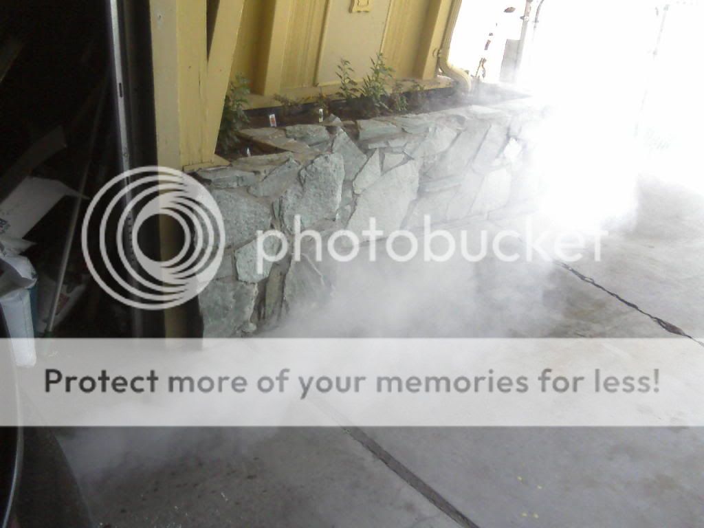

GGGAAAAAAAAAAAAAHHHHHHH!!!!!!!!!!
it was about 75 or 80 degrees out when it did this! I've noticed in the past that it does it worse if you let it sit idling for a minute or so before you shut it off. all the plugs were set at .040 so I opened them up a little to get them right.
-edit- I still have no codes on this thing!

the majority of it isn't oil, it really is fuel. normally I can get 300 miles to a tank, this time I'll be lucky to get 250. I'm going to put injectors in it next, but probably not until the weekend. my valve guides probably are bad, but that's not the biggest part of this. if I can get the white cloud out of the way, I can live with a blue puff in the mornings. at least we know what it's not.
Re: what the hell is wrong with my car?
If it smokes blueish when you first start the car after sitting for a day or two then the smoke disappears, valve seals. But hey on the positive side, nice stone work on the house.

thanks, but it's not my house, it belongs to my mother-in-law.
