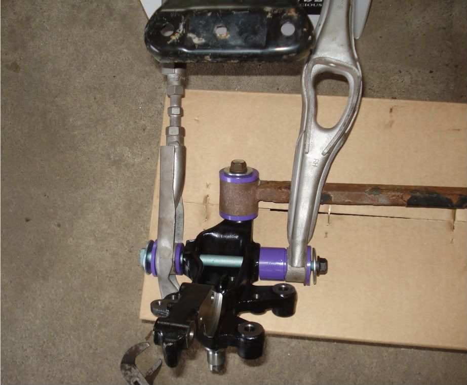

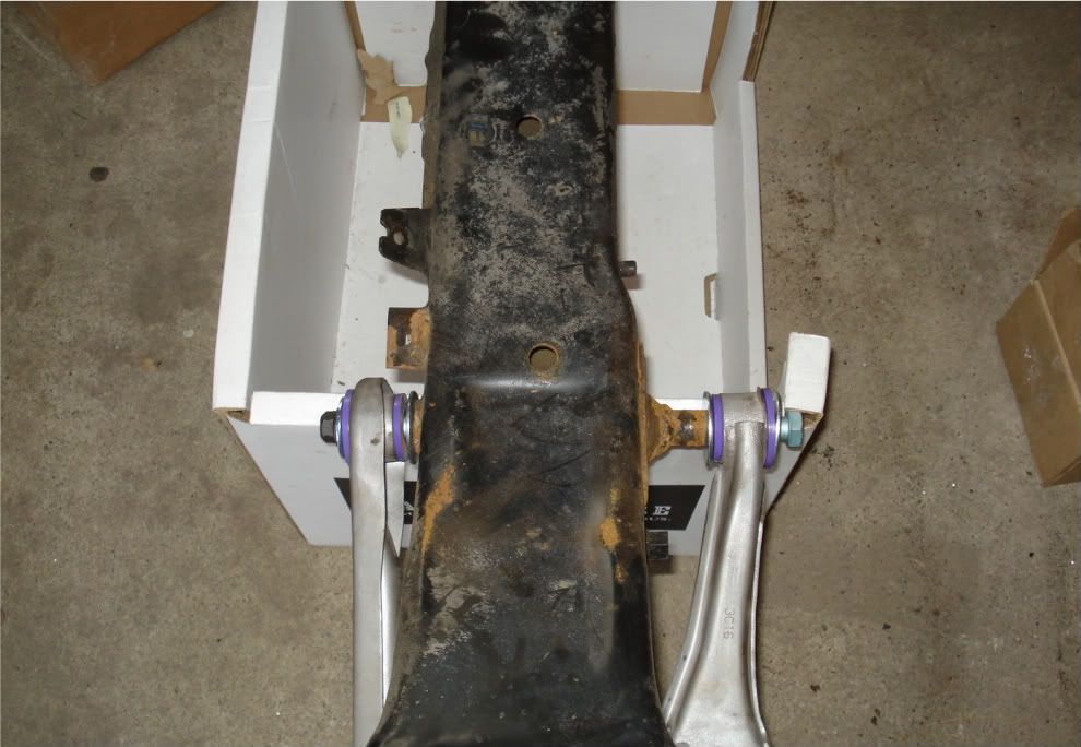

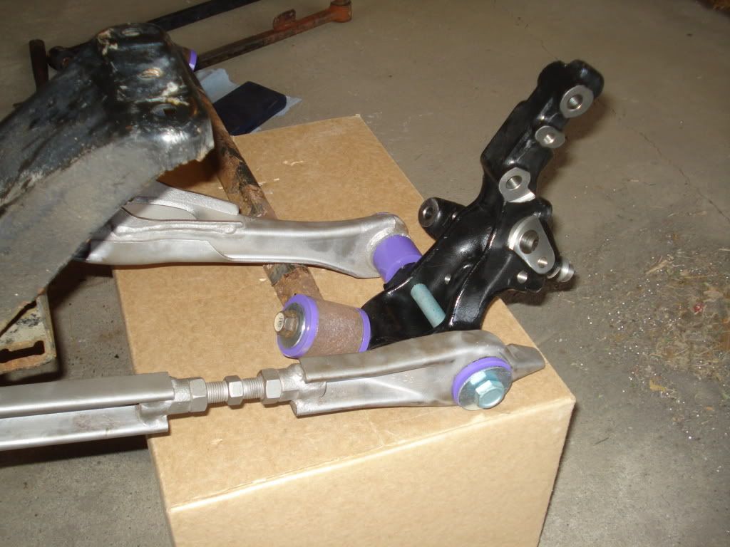

A few pics of the dry test fit. I used this old rusty subframe I had laying around, but I went and got a nice set of lateral links at the wreckers yesterday to be sure the fit would be right. I have checked all the parts and everything fits perfectly. A couple of the sleeves have to be adjusted but that's not a problem. The poly parts are perfect. (I just noticed that I have one Lateral Link on backwards...dur).
The LCA's are perfect too, but for some reason I failed to take a picture of them. Trust me they're awesome.
I will get a few shipping quotes and come up with a reasonable flat rate. I expect it to be about $25-30CDN. Those of you on other continents obviously will have to be dealt with individually. Please start preparing to make your final payments. Those of you who purchased full sets will owe me $170CDN + shipping. Those of you who have already paid in full for partial sets will only owe me shipping.
I am going to place the order with the Poly manufacturer by the end of the week. I expect it will take them 3 weeks to fill the order. I hope to have all the parts in my possession by the 7th of August, however don't be surprised if they bump us a week for a more lucrative job. They aren't making very much money off of me so understandably, they sometimes do that.
I will produce a comprehensive set of instructions as well...in case you have any questions about the installation.
