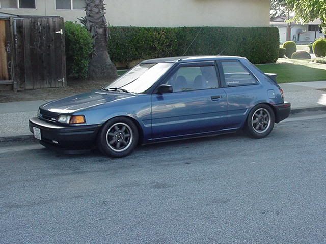

Got a Mazda 626 front lip. (They look cool on 323's) I also got hood pins and lanyards.
Pic of 626 front lip on a 323 (not my car)
