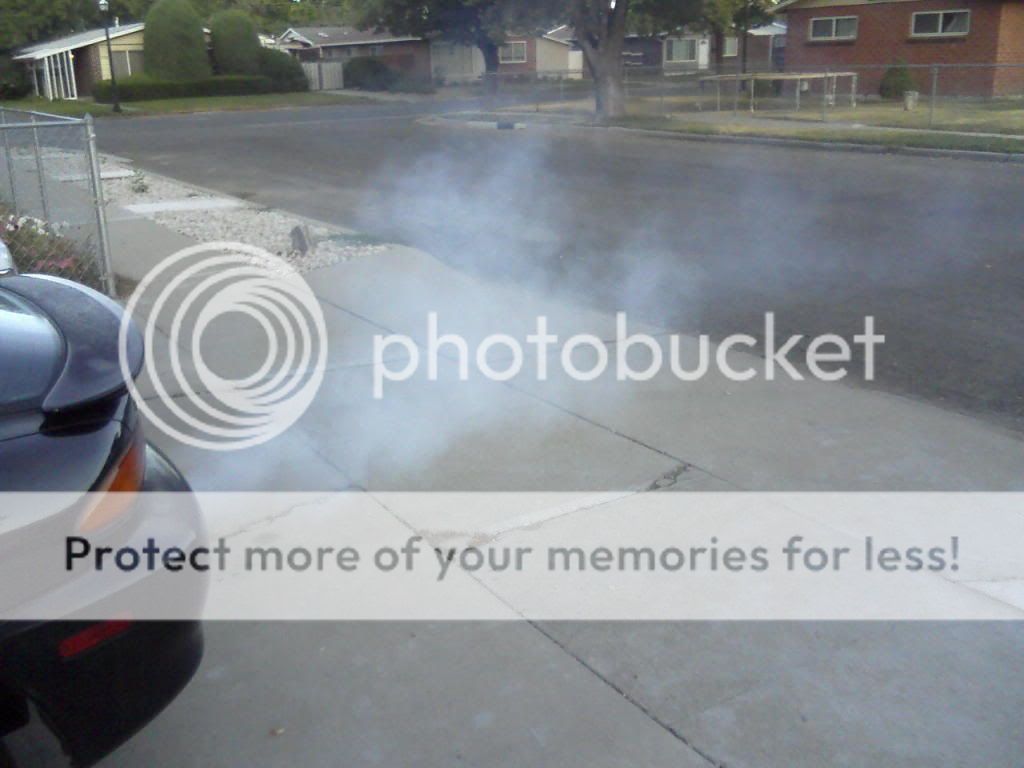

this morning's cloud:
looking at it, there is a bit of blue after all, but it's not like the whole thing is oil. I'm going to do the head gasket this weekend anyway and hope everyone's right about it, but I honestly don't think it's that. still smells (mostly) like excess fuel to me. as for the new sensor being bad, I get it completely. but it would have put up a code again, I would think. I have no codes at the moment. on a positive note, it's running pretty good now that I did the plugs and wires. so, when I do the head gasket I was thinking about trying to undo all the wiring and stuff to the intake and just leave the manifolds on the head when I pull it off. or is that more of a pain in the @$$ than it's worth? also, are there valve guides or seals or something like that I can replace while I'm at it?

I'd say there's a LOT of blue in that smoke, not a little. That's definitely not coolant.
However, being that it stops smoking when it gets hot, I still think it's the head gasket.
You can, once you get the head off, take it to a machine shop. They will hot tank it, deck it, check the guides and replace the valve seals, among other stuff. I don't know how much they charge where you live, but here in Miami, they normally rebuild your heads for about $40 each, plus the gaskets.
