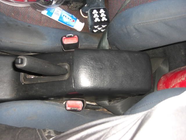

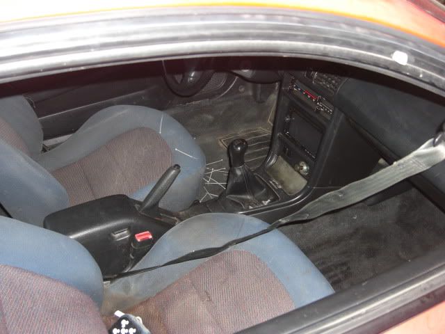

i finally got some extra cash to work on the car just got back from the pick and pull and i got some goodies for my car. that i didnt have when i bought it 5 years ago. ended up buy a new center console, working ashtray, a radiator but i may not need it i just needed the support and the rubber spacers for it . i also found the trunk cover. i got the this all for about 65. i dont think that is expensive..... i still have yet to find a bumper with the reinforcement i also need to get a new valve cover gasket set. hopefully it wont take long. ill be workin on it saturday so ill be posting pics then of the new stuff as well as running my wires from the avic d3.

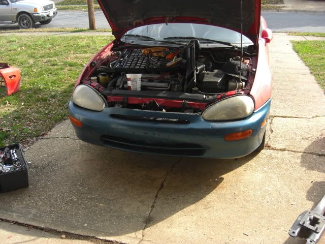

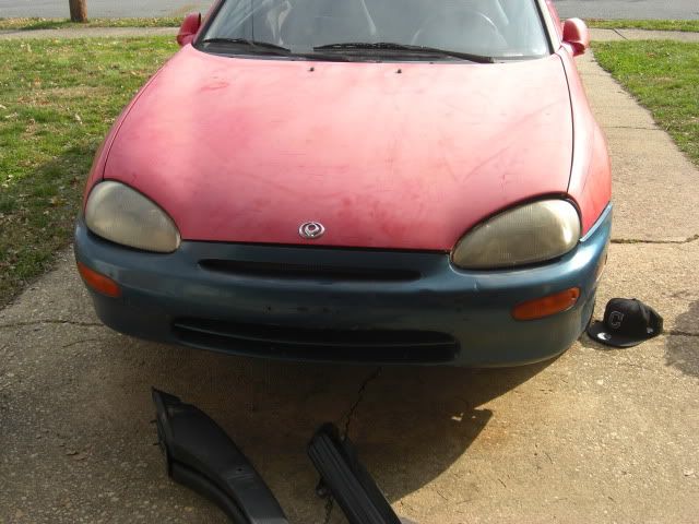

AS IT SITS RIGHT NOW

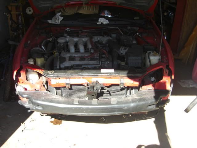

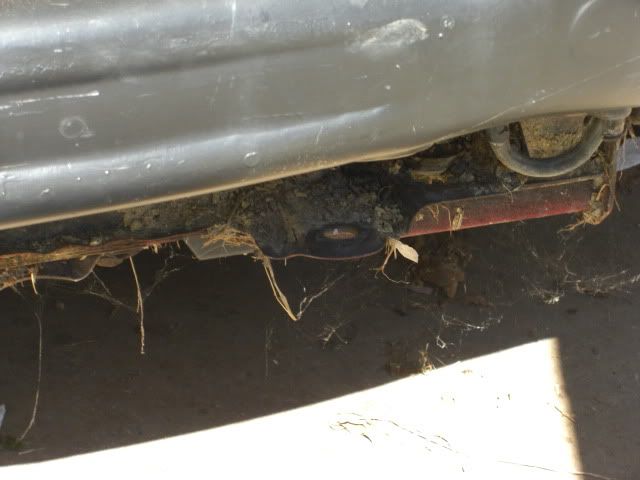

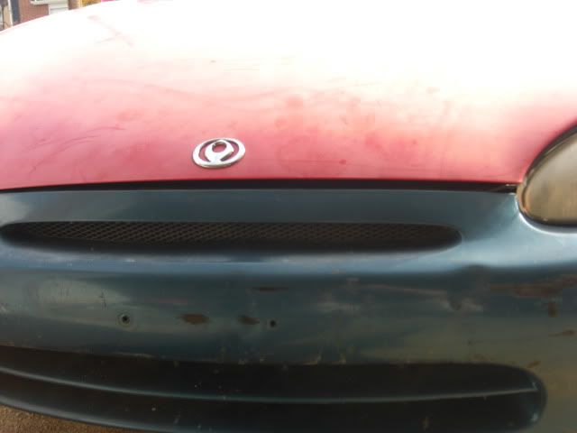

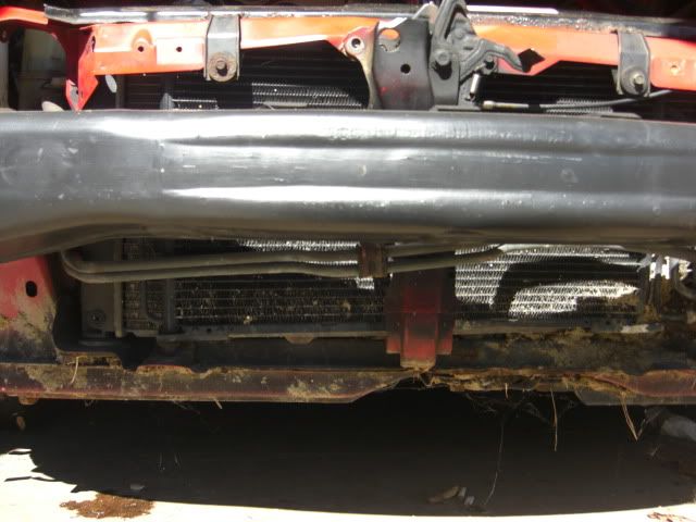

THE DAMAGE. NOT THAT SEVERE I THINK BUT WHO KNOWS.
THE DITCH RIPPED THE RAD. RIGHT OUT.

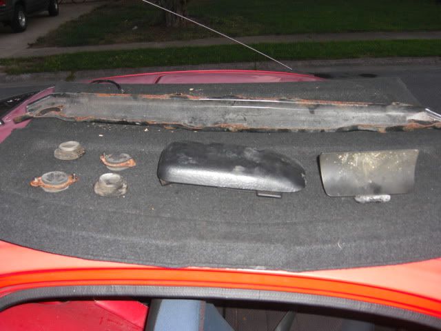

THE NEW GOODIES MINUS THE RADIATOR.

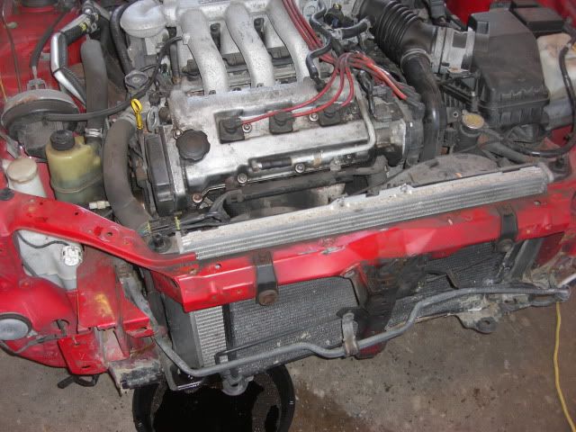

antifreeze and oil change. still no bumper i however did get some extra money so im on the prowl for some goodies.

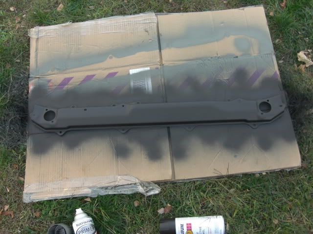

fresh painted rad support.

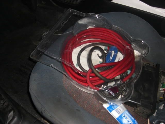

ok so this weekend im gonna grab my bumper, i also am thinkin about grabbing some other parts for a klde. im gonna get a klze but i do want to rebuild a klde as a back up in case i want to explore with boost. the system wires are ran finally lol. and even though the bumper is 150.00 i really need it.

heres the new bumper. i need to find some clips to hold all the end parts on i cant remember what held it on.

For bumper fasteners....
There are three special type push clips that go in the mouth, on the top.
There are L shaped brackets with little screws that go from beside the headlights, down behind the bumper support
There are two screws that go from the upper corners into the fenders.
There are two of whatever-works-for-you that hold the bumper out at the bottom, against little brackets that stick out from the body. Just crawl under and look, you'll see them. They're on the corners, under the turn lamps.
