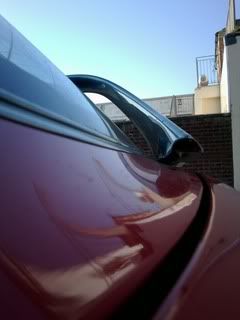

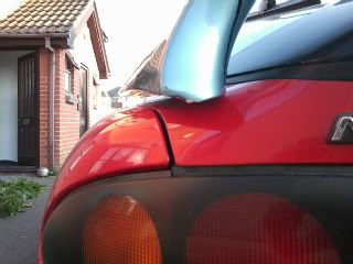

My main cause for concern is the feet of the spoiler
are way off the contour of the hatch.
It either needs shaving to match, or a piece made up
in plasticine first, then moulded properly?

Yah, how i would do it is one of 2 choices of how i would do it.
1- you can cut the inside base until you reach the desired fitment and rework the base with fiberglass and screws, but this method will lower the overall height of your spoiler.
the other way, would be to extend the base to fit. you could use some plastic wrap or something of that nature that will stick to your car without actually adhering to the car. then use some single expanding spray foam to fill in the gaps. let it dry and you can reshape it and the underside will match that of the car perfectly, and all you have to do is epoxy and or fiberglass some bolts in place for mounting.
you could use the blue foam to do the same thing and make an adapter so to speak to mate the spoiler to the car it will just take a while for shaping.
In the past i have used Toilet floor bolts, they are a flat winged head making them real easy to fiberglass or epoxy in place. and they come with a locking nut

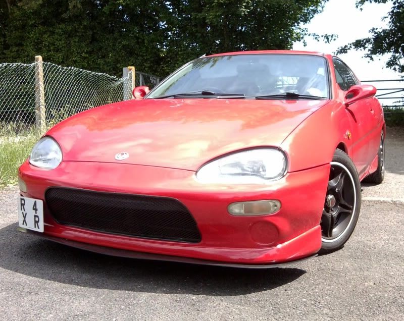

Re: UK Sam's 1.6 Turbo MX-3 project
wow I hadn't looked at this worklog! that front end looks awesome!
Thats ok mate I'll forgive ya
Totally changes the characteristic's of the front end doesnt it
indeed - is that black bar at the top the bumper support?
Yeah it is, does a great job of holding the mesh in place tightly,
and its completely unmolested, well apart from two pilot holes
for the splitter support tie rods
